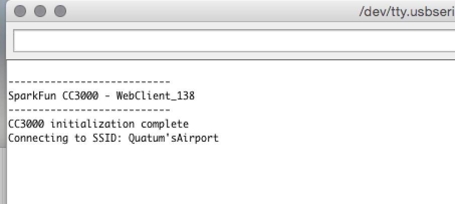

CC3000 + MKS Gen V1.2 can not run WebClient Demo on Arduino IDE, but can run the scan AP demo.
1. Hardware: CC3000, MKS Gen v1.2;
2. Software: Arduino IDE, Arduino Board:Mega 2560, all library files have been rewritten for MKS.
3. OS: OS X 10.10, Arduino IDE 1.5.8
4. Problems: Serial Monitor's result stopped at "Connecting to SSID". And D4 light flickering.
4. All this system (hardware and software) can run the Scan demo (rewritten) in Arduino IDE with accurate result.

  • Thanks for answering my question.
    Both of two methods, manual way and SmartConfig, were used for my Arduino System.
    All of demos(SmartConfig, WebClient, Scan...) were rewritten which based on the SFE CC3000 Library from GitHub.
    1. Redefine Pins of CS, EN and INT.
    2. Use the constructor of new Class SFE_CC3000.
    I was wondring why Serial Monitor had no results when I ran the smartConfig and WenClient on the Arduino. But Scan Demo can run Successfully with results (Nearby AP names Showed).
    I will check the website and parameters, thanks again.
