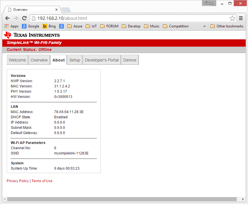

Now I am moving to second step. Trying to work out a way to config network when first time using the device. I tried internal web pages, and seems networking information didn't refresh on the status.html even though the device was connected to network. What am I missing? Or I need to do sth on HttpServerCallBack though those are predefined tokens?

    The device is in STA mode, and i flash with the OOB webpages. On About page, IP Address, Subnet Mask, Gateway couldn't be refreshed with current values in DHCP mode. However, if using static IP, these parameters were reflected right on the page.
  • Ankur,
    Leo is referring to the absence of details in the LAN section. This has always been the case and I believe it is due to the details only being obtained and hence shown when in access point mode and not station mode. It is confusing however.
    Glenn.
  • Hi Glenn,
    In AP mode, with DHCP diabled or using static IP, the LAN info were shown right. Only with DHCP enabled, LAN info were shown wrong, but not 0.0.0.0.0, though, seems some random address.
  • Hi Leo,
    As Glenn mentioned in station mode you won't get the IP, Subnet Mask and Gateway using pre-defined tokens if the DHCP is enabled and should get the correct values if static IP is used. If you want to get the these parameters on web page in STA mode you can always implement it on application side. Please refer to http_server or provisioning_ap examples for reference.
