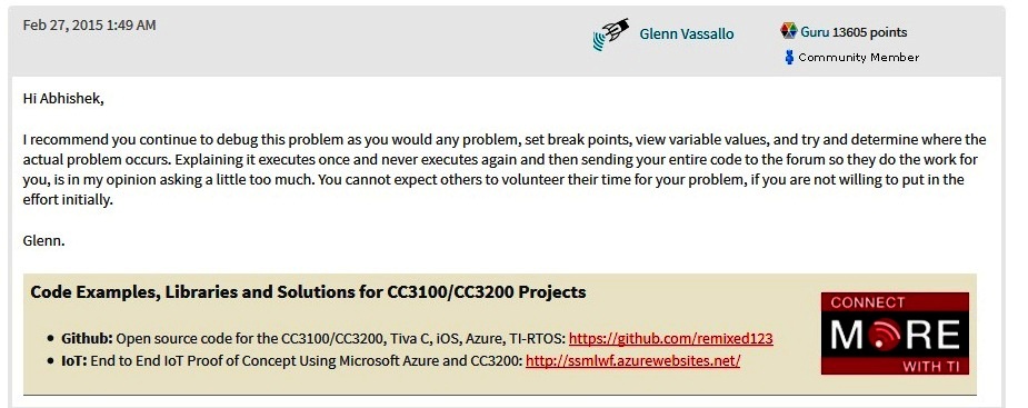

  • Hi Abhishek,
    Thank you very much for generously volunteering time from your busy schedule to help me with this.
    Abhishek Ekhare said:
    Actually, i was busy with other things (which you have already figured out in other threads of mine!!).
    Yes I have seen your recent request for assistance and the many others you have made over the previous month or so. I hope the community has assisted you in getting up to speed so you can succeed at your job and build a product based on the CC3200.
    I am sure you appreciate all the help you have received from others, and I also hope you got something out of assisting another community member.
    Glenn.
