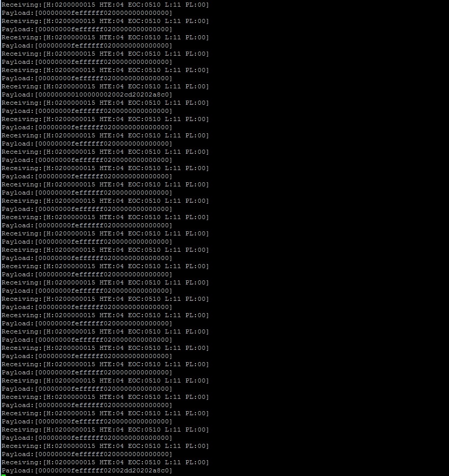

  • I have tried to log the HCI_EVENT_ACCEPT coming from the module. See the picture below.
    All the rows in the picture looks good to me, accept is returning -2 as expected, except the last one. This is what happens when accepts stops responding. As you can see in the last row accept is returning -2 but my IP (and port) is there too! Is this a expected behaviour, returning -2 and an IP address?
    Do you know if any one "out there" have been using the CC3000-module in non blocking as a TCP-server successfully?
