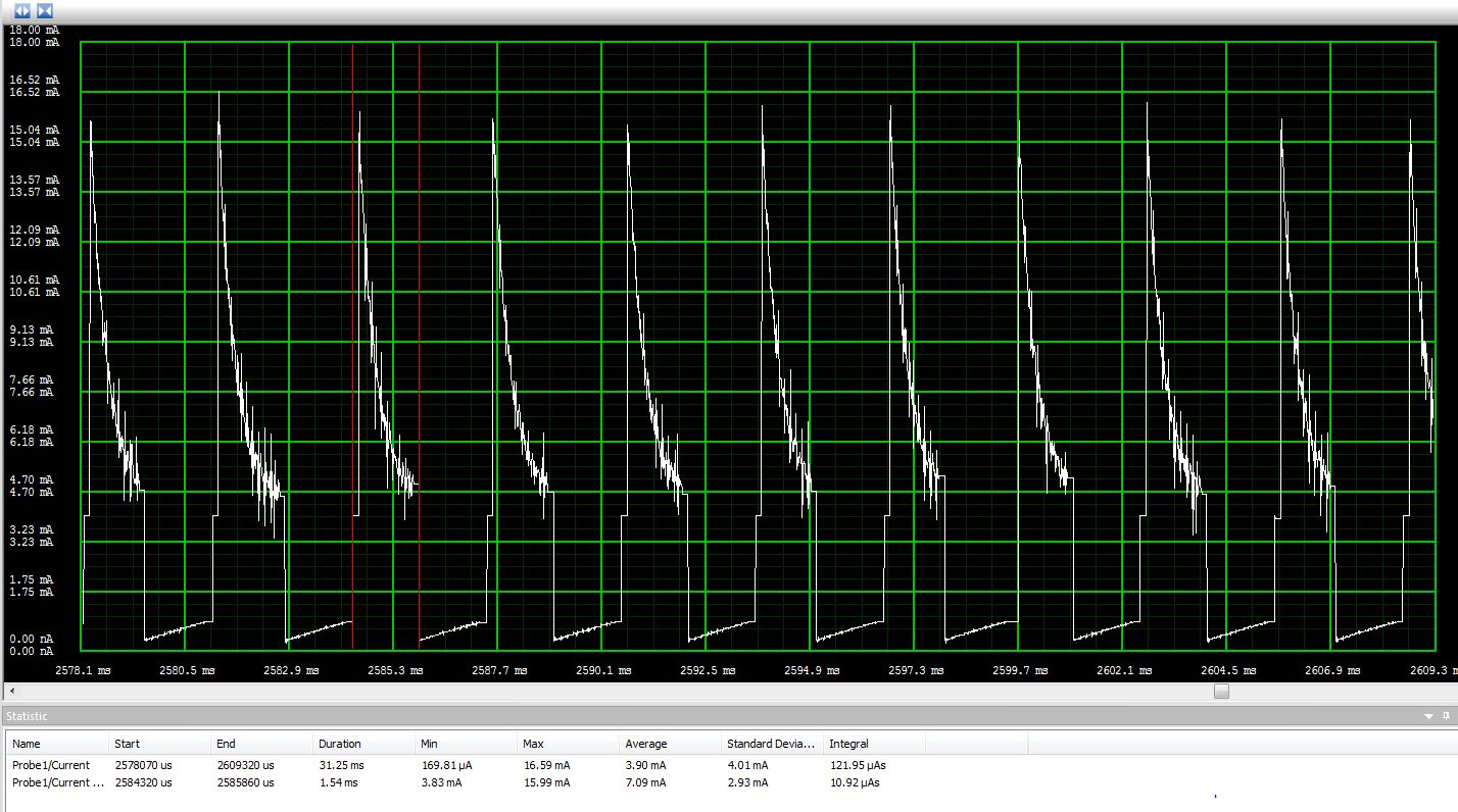

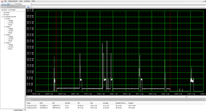

I am trying to put a CC3200 into low power mode using pieces of the Idle connect sample application
I think I have done everything necessary to go into LPDS
But it oscilates out ever 1.5 ms
Is this related to the systick timer ??
Or is something else interrupting and causing the wake up
I am using the RTC to wake up every 15 seconds, and that is work correctly
Anyone have any ideas ???
