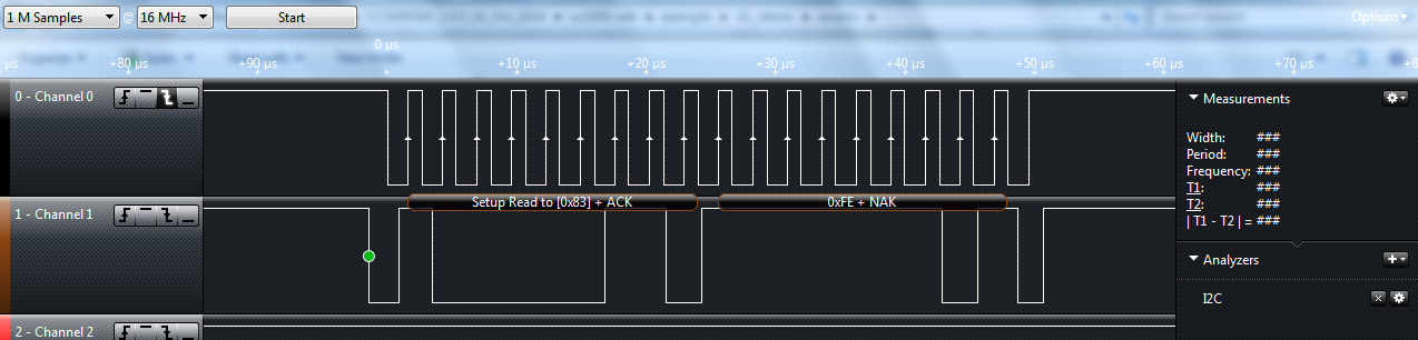

  • Hi Nirmala,
    Is this call, Wire.I2CTransact(I2C_MASTER_CMD_SINGLE_RECEIVE ),  you are expecting  to generate a NACK followed by STOP condition.
    I could see this function generating the expected result ( I am using I2CTransact function from i2c_if.c not  energia )
    Here is the waveform
    Thanks and Regards,
    Praveen
  • Hi Praveen,
    Thanks for the reply.
    I tried it with i2c_if.c from i2c demo example but my change line is still not getting high. I do not have scope to test the output on my arrangement, but as per your screen shots it is sending Nack in i2c_if code, so i will have to look into other aspects.
    Please suggest any other direction in which i can work on if you have any in your mind.
  • I got it working. Changed the pull-up resistance value. Thanks Praveen.
