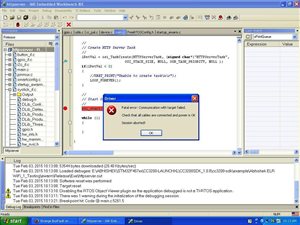

    Thank you very much for replying.
    Now i am able to program the device using UniFlash.
    I am also able to connect the JTAG and "Download and Debug" from IAR workbench.
    But as soon as i press the run icon, the program runs upto osi_start() instruction, but after that "Communication Failed" error appears. (I have put a breakpoint at osi_start() in httpserver code.)
    What might be the problem ??
    Please help !!
    Warm regards,
    Abhishek.
    PS: The same code works perfectly on CC3200 LaunchXL launchpad.

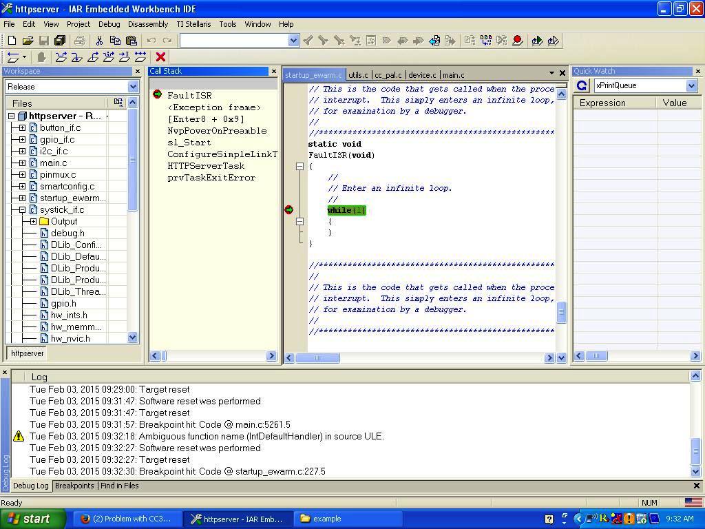

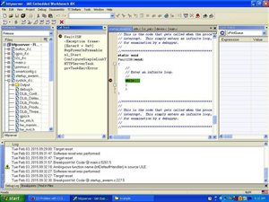

  • Also, when my code runs without the "Communication Failed" error, it gets struck in static void
    FaultISR(void) or static void
    BusFaultHandler(void).
  •  Here's a screenshot of the above situation...
  •  And here's the communication error...
  • Hello all,
    I checked everything in my code and hardware.
    Although the code was correct, the actual problem was with the hardware.
    After checking the GPIO and Power connections, i found out that the 40MHz crystal was not soldered properly.
    As a result, the CC3200R1M2 chip was not working, and hence i was getting communication error.
    Now my problem is solved and i am able to execute my application.
    Thank you all for your help and support.
