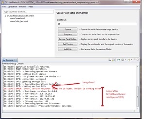

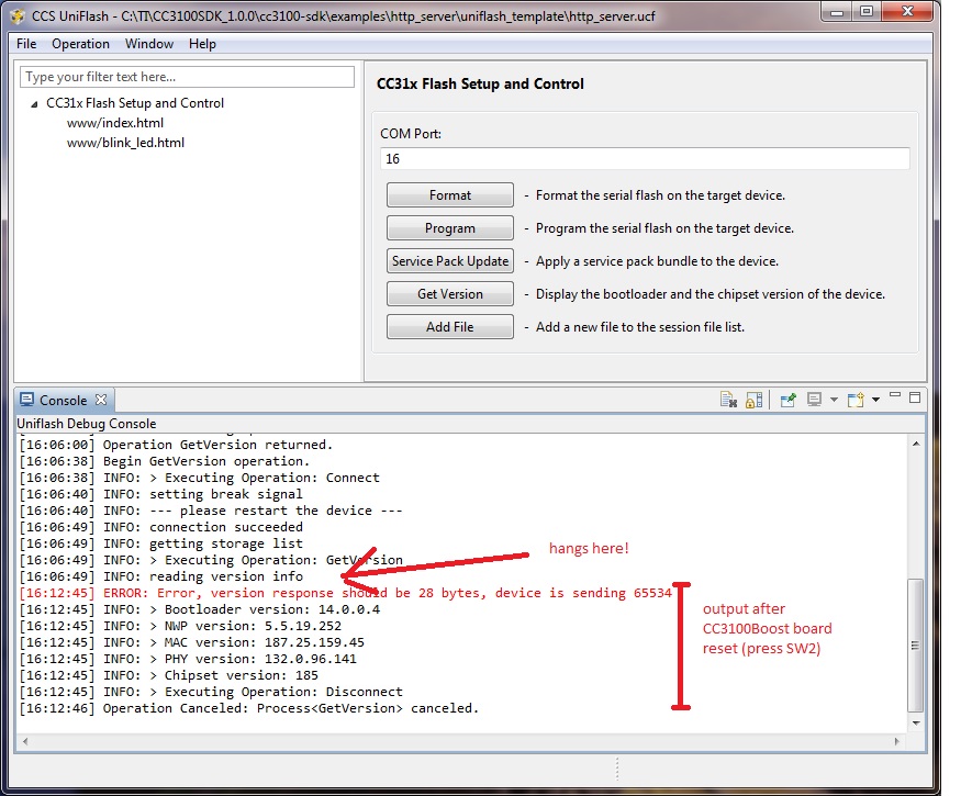

There is a problem reading version of CC31XXEMUBOOST/CC3100BOOST using Uniflash.It seems to hang unless I hit the reset push button on the board. And then I get an error message:
Error, version response should be 28 bytes, device is sending 65534
...followed by some version info.
Any idea what is wrong?
Fred
I attached a picture.
