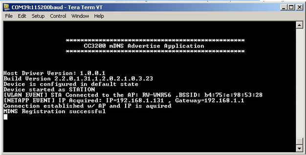

When using the CC3200-LAUNCHXL to run the MDNS Application example code from the 3200SDK in Code Composer Studio 6.0.1 debug mode, I see the following output from the Terminal:

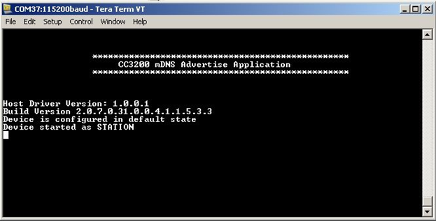

The problem is when I run the code from my custom PCB I see the following:
Note: I have hardcoded the access point name and password so it should connect on boot. I have also tried other application examples such as the out-of-the-box and wlan_station examples with similar results.

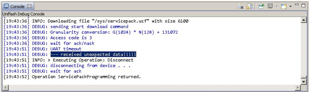

I have tried updating the service pack using the CC3200 UniFlash tool with hope that it might help, but the UART always times out during the operation, even though there are no issues with formatting, programming, or reading the version information.
Trying to investigate why the updating the service pack fails you can see below where the CC3200 fails to respond.

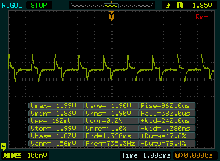

When probing the RF Pin(RF_BG/Pin 31) I see no output at all on the custom board.

  • The crystal oscillators are outputting the correct frequencies.

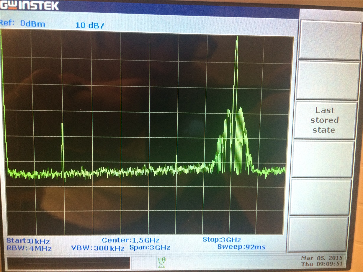

  • The antenna and filter design is functional. This was tested with a spectrum analyzer tracking generator. We attached the spectrum analyzer to the RF Pin of the microcontroller (RF_BG/Pin 31) and used the tracking generator to confirm signal transmission.

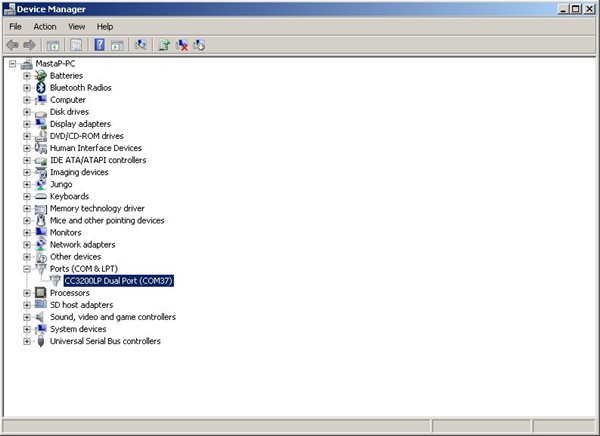

  • COM Port 37

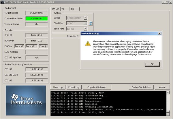

  • Leo,
    I hope we are on track to resolving the issue. We attempted to use the radio tool, but are unable to get past the initial steps.
    Steps we did:
    Flashed the radio firmware, radio.tool.bin, onto the CC3200.(Erase, update, and verify checked) - appeared to have no issues
    Removed the SOP2 jumper
    Launch the CC3100/3200 Radio Tool v1.0.5358 Application
    We are able to connect, but a device warning pops up fails as followed:
    Possible issues:
    From the radio tool, "Note: The Radio Tool version matches SDK version. For example, if the Radio Tool has a version as 0.5.x.x, you'll need to flash the devices with Service Pack 0.5.x."
    We can not flash the service pack so we are unsure how to determine which service pack version is currently on the device.(Tried using previous versions of the radio tool...Same result)
    Additional details:
    We followed this same procedure with a LauchXL and it worked fine.

    "Update the Service Pack" Debug Console Output
    [15:32:12] Begin ServicePackProgramming operation.
    [15:32:15] INFO: > Executing Operation: Connect
    [15:32:15] DEBUG: waiting and clearing uart rx buffer
    [15:32:17] INFO: setting break signal
    [15:32:17] INFO: --- please restart the device ---
    [15:32:17] DEBUG: wait for ack
    [15:32:17] INFO: connection succeeded
    [15:32:17] INFO: getting storage list
    [15:32:17] INFO: > Executing Operation: ServicePackProgramming
    [15:32:17] INFO: Path to the service pack file: C:/ti/CC31xx_CC32xx_ServicePack_1.0.0.1.2/servicepack_1.0.0.1.2.bin
    [15:32:17] INFO: reading version info
    [15:32:17] INFO: CC3200R Device detected.
    [15:32:17] INFO: NWP/MAC/PHY Version from Service Pack:
    [15:32:17] INFO:  NWP Patch version: 2.2.0.1
    [15:32:17] INFO:  MAC Patch version: 1.2.0.2
    [15:32:17] INFO:  PHY Patch version: 1.0.3.23
    [15:32:17] INFO: DEVICE CC3200 ES1.33
    [15:32:17] DEBUG: Bootloader version is 2, 1, 4, 0
    [15:32:17] DEBUG: It's a CC3200 device: PG1.33 or higher
    [15:32:17] DEBUG: Switch UART pinmux to APPS
    [15:32:18] DEBUG: Switch to NWP bootloader complete
    [15:32:18] INFO: reading version info
    [15:32:18] DEBUG: wait for ack
    [15:32:18] DEBUG: Bootloader version is 2, 0, 4, 0
    [15:32:18] DEBUG: raw storage write
    [15:32:18] DEBUG: status request
    [15:32:18] DEBUG: BlockSize is 4096, number of blocks is 16
    [15:32:18] DEBUG: erasing 13 blocks starting from  0
    [15:32:19] DEBUG: wait for ack
    [15:32:19] DEBUG: status request
    [15:32:20] DEBUG: wait for ack
    [15:32:20] DEBUG: status request
    [15:32:20] DEBUG: 0
    [15:32:20] INFO: Downloading file "/sys/servicepack.ucf" with size 6100
    [15:32:20] DEBUG: sending start download command
    [15:32:20] DEBUG: Granularity conversion: G(1024) * N(128) = 131072
    [15:32:20] DEBUG: Access code is 3
    [15:32:20] DEBUG: wait for ack/nack
    [15:32:35] DEBUG: UART timeout
    [15:32:35] DEBUG: --- received unexpected data!!!!!
    [15:32:35] INFO: > Executing Operation: Disconnect
    [15:32:35] DEBUG: disconnecting from device . . .
    [15:32:35] DEBUG: wait for ack
    [15:32:37] Operation ServicePackProgramming returned.

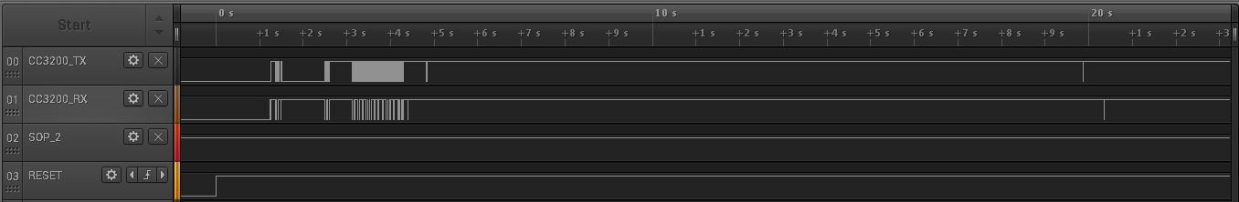

    3. It seems you have saleae logic. Can you provide the capture files (not the screen shots only) for formatting, successful programing and failing Service Pack programming? It can shed light on the root cause.

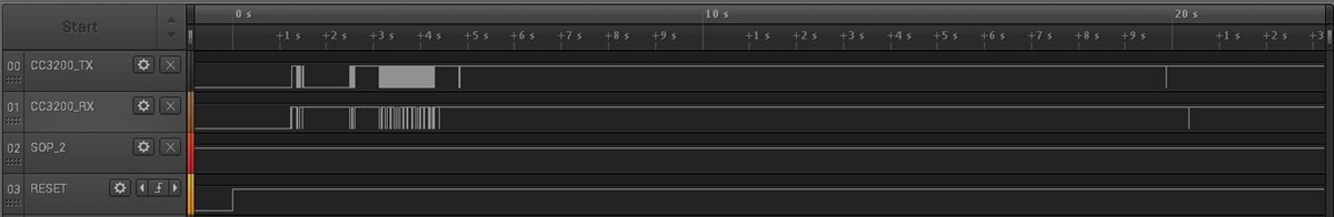

  • 1. The attempts to program the sflash came from the original "out_of_box.ucf" file with no modifications from the cc3200SDK_1.0.0. All of the files within that UCF configuration are less than the file size of the service pack individually.
    2. The Uniflash version is: 3.2.0.00120 for all our operations.
    3. The output of the Seleae logic generate .logicdata file sizes that are very large, so I compressed the file and posted the smallest one that would fit on this site and added a dropbox link the other files that wouldn't fit.
    Get Version Capture:
    Get Version Capture.zip
    Fomatting 16MB Capture:
    Link
    Programming with large file Capture:
    Link
    4. Our design currently incorporates a 16MB SFLASH part that operates at 108MHz. This part was chosen from a list of compatible parts found in another post on this forum  which can be found at the link below:

     UPDATE:
    Attempts to flash the cc3200 with a larger file size than the Service Pack resulted in the same UART timeout error seen while trying to update the Service Pack. This was also tested with the same process on the Launchpad and it programmed successfully. The Uniflash Debug Console Log is shown below:

    [16:00:18] DEBUG: UART timeout
    [16:00:18] DEBUG: --- received unexpected data!!!!!
    [16:00:18] INFO: > Executing Operation: Disconnect
    [16:00:18] DEBUG: disconnecting from device . . .
    [16:00:18] DEBUG: wait for ack
    [16:00:22] Operation Program returned.

  • Hi Joshua,
    Thanks for the details info. For some reason I'm not able to open the saleae files but I think I know what the problem is.
    As suspected, I believe it is related to the erase time of the 4KB sub-sector.
    Uniflash assumes a worst case of 200mSec per block multiply by the number of blocks or 15 seconds, the maximum.
    So let's take as an example the 131072 bytes. You can see from the log it takes ~8 seconds:
    [09:25:47] DEBUG: Granularity conversion: G(1024) * N(128) = 131072
    [09:25:47] DEBUG: Access code is 3
    [09:25:47] DEBUG: wait for ack/nack
    [09:25:55] DEBUG: receive ack
    Calculating per block yields in 8000/(131072/4096) = 8000 / 32 = 250mSec.
    Looking in the data sheet, it is the same typical value for sub-sector erase. The max value is 800mSec.
    So, it is a very slow serial flash in terms of erasing blocks.
    Now let's calculate the same for the larger file. The size is 372188. Taking 250mSec yields 372188/4096 * 250 = 23 seconds!!! Uniflash waits for 18 seconds, hence the timeout.
    Please note there is always a tradeoff. If we increase this time per block it would mean larger timeout in case of UART issues. So, it may be a good idea to make it configurable somehow.
    I'll think of a way to verify my theory and let you know.
    Shlomi
  • Thanks for your input! I will fix the  saleae files so they can be opened and also work towards testing this theory.
    With regard to the theory that the flash being slow is where the error is originating. I have the following questions:
    • Is there away around this issue?
    • Should we consider an alternate Flash IC?
    • Does this have other non-obvious detrimental implications?
    Thanks for your continued support and we look forward to your reply!
  • Joshua,
    You can use this flash, just need an updated Uniflash to support it.
    Attached is a library FlashAPI.dll. Can you please replace your current file with this one and check?
    It is under .\eclipse\plugins\com.ti.uniflash.wireless.files_1.0.0.201502021424\cc3xxx\bin (save a copy of the original one).
    This one is with larger delay and should be enough in your case.

    • We programmed the cc3200 chip with the radiotool.bin file provided with the Radio Tool, which was also completed successfully. The erase, update, and verify option was checked during the programming operation.
    • After removing the SOP2 jumper, we tried to run the Radio Tool the console debug information is shown below:
    [3/3/2015 4:02:07 PM] Program Ready, version 1.0.5358.30883
    [3/3/2015 4:02:30 PM] Connecting...
    [3/3/2015 4:02:30 PM] Connected
    [3/3/2015 4:02:30 PM] Fetching Information
    [3/3/2015 4:02:30 PM] Chip ID=0x10 (CC3200R), ROM_ver=0x3333, FW_ver=2.2.0.1.31.1.2.0.2.1.0.3.23, MAC=54:4A:16:29:AF:0F
    [3/3/2015 4:02:58 PM] Tx Testing Started
    [3/3/2015 4:04:32 PM] Tx Stopping...
    [3/3/2015 4:04:32 PM] Tx Testing Finished
    Results:

  • Hello Joshua,
    Can you probe the voltage level on the device pin 33 ( which is the C 42 on the Launch pad board)  during the transmission? It would be helpful if you probe it using an ossiloscope since you might see the voltage go low in between. I am interested in knowing the voltage level when you see the level is high.
    You can also measure the voltage on pin 48 (C 31 in the Launchpad).
    Dham
  • Dham,
    Thanks for dropping in. I have measured the voltages and checked over the circuit. In doing so I may have may have found the culprit of our issue, but I'll let you weigh in on if this is the issue.
    Pin 33:
    • TX ON: 1.92V
    • TX OFF:  ~0V
    Pin 48:
    • TX ON: 1.96V
    • TX OFF: 1.96V
    I tested this with the launch pad and noticed a difference in the waveform on pin 48. I checked over the Schematic and noticed that mistakenly Pin 36 (LDO_IN1) has been left not connected(NC) when it should have been shorted to Pin 25 (LDO_IN2).
    Our waveform on Pin 48 is a constant DC voltage(no waveform) during TX ON while on the launchpad this is not the case.
    Launchpad Pin 48 TX On image below:
    Update:
    Improvements were verified by connecting the LDO_IN1 and LDO_IN2 pins on our circuit. We programmed the cc3200 with the wlan_ap example and the test SSID showed up on our WiFi enabled devices.
    Note: All voltage outputs on PIN 48 and 33 look identical.
    Testing the RF output yielded positive results. See image below for output from the RF switch.
    Problems:

  • Hello Joshua,
    You rightly mentioned that the RF problem was due to not connecting LDO_IN1. This would mean some of the RF section was not getting any supply. Glad to hear that after fixing this you are now able to see the RF output on the sepctrum analyzer and Rx is also working.
    About the AP connection issue, can you check what is the ppm error on the reference clock? If you have a WLAN analyzer you can trasnmit a paclet (say 54OFDM) using radio tool and recevie it in the WLAN Analyzer and that would indicated the center freqency error or ppm error. The ppm error should be < 25ppm for proper communication between the transmitter and recevier.
    If you dont have a WLAN analyzer you can use the radio tool to transmit a CW and select tone '1'. This would transmit a RF tone at 312.5Khz away from the center frequency. ie if you tune to channel 1 (2412 Mhz) this would transmit a unmodulated tone at 2412.3125 Mhz. You can measure this frequency on the spectrum analyzer and see the error from the expected frequency. This error should be less than 25ppm ( ie < 60khz). For accurate measurement use a low span and low RBW (<1Khz ) on the spectrum analyzer.
    The ppm error would depend on the load capacitance on the 40Mhz XTAL connected to pin 22/23 (including the parasitic capacitance on teh PCB). If the frequency if off you might need to adjust the shunt cap on the XTAL P/ M pins to center the frequency and reduce the error.
    Dham
  • Dham,
    We are working! Caps did the fix. We do, however, have just a few more questions. I have tried flashing the SFLASH with a 'Debug' configured version of our firmware using Uniflash, and even though the operation was successful, the board showed no signed that the firmware was operating correctly. Everything is fine however if a 'Release' configured SDK example is flashed instead. Would the difference between Debug and Release cause any issues on how the program works after being flashed with Uniflash?
