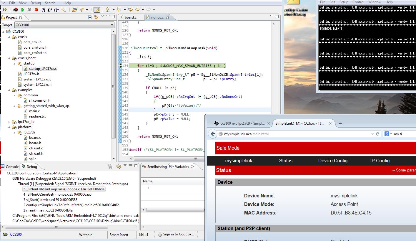

  • Hi Ankur,
    thank you for your quick reply,
    This is a screenshot with debugger, serial console and Website:
    The application never leaves sl_Start().
    I Don't have connected my bp Hardware to my lpc1769 board yet.
    Otto Parzhuber
