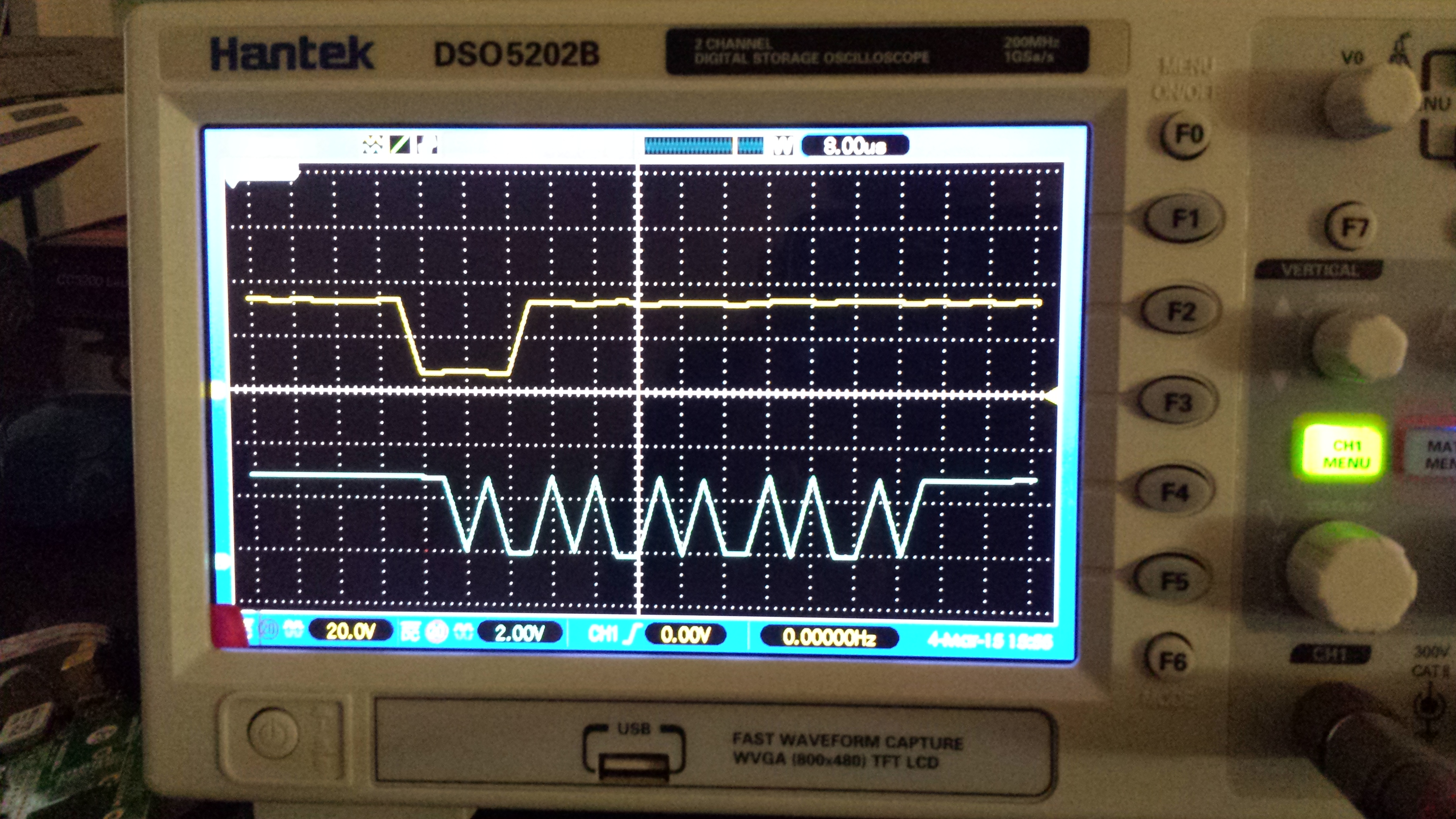

  • Hello Steve,
    Resistors on pull up are 1K.
    The picture of scope attached (when we send "readreg" command to accelerometer using TI-RTOS).
    Top (yellow) signal is DATA and lower is CLOCK (blue).
    What do you think about it?
  • Those edges don't look right at all.  It looks like you may have a ton of capacitance on your lines.  Do you have a lot of devices connected to the I2C port?  IME 1K is probably too low for a pullup value, but your edges clearly aren't moving fast enough.  I'd try to figure out why your lines have so much capacitance before I do anything else.
    Are you trying to run 100KHz or 400KHz?  I recommend starting with 100KHz to keep it simpler.

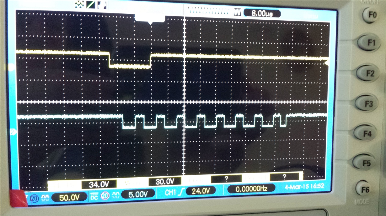

  • There is only a one device (accelerometer) connected on address 0x1C.
    I tried 100KHz.
    I do not see the address is transfered.
