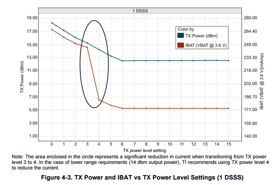

    But according to CC3100 Datasheet (page 12) every TX_Power parameter value (0-15) yields a transmission power that is no less than 12.5dBm:
    Given that we don't control what bit rate the CC3100 will use for the transmission and we know that for each bit rate the tx power parameter (0-15) gives a different transmission power changes (in dBm), how can we ensure that it won't pass a certain tx power (dBm) without dependency of the chosen bit rate?
    Does the 'WLAN_GENERAL_PARAM_OPT_STA_TX_POWER' definition is different than 'TX Power level' mentioned in the datasheet's graphs?

  • Hi Nir,
    The description in the DS is correct.
    You can't control the Tx power in a higher granularity than that.
    Meaning, you can't control the exact power per rate, per channel, but only reduced the maximum output power of the device, covering all channels and rates.
    Alon
