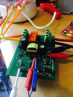

Meantime,  we've progressed from using the CC3200 Launchpad to developing our own boards and writing some code...  And hurrah, this week week we made some progress..    We have designed a board, that measures Power consumption data, and controls a relay to switch a load on/off.   Data is sent to/from the board via MQTT.    Its functioning reasonably well, as a prototype.       ( NB, this has its own AC/DC power supply on board, thats what the transformer is for ).  In the picture its hooked up to low voltage ( 12VAC ) via that big transformer and a DC power supply so we can safely probe it, and work with it. The moment it gets on the AC, we can't work on it, nearly as easily.. ( safety! )
