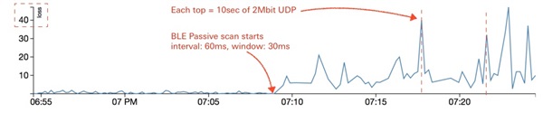

Experiencing a Wi-Fi performance drop when the wl183x is running passive scan (one paired device).
The odd thing is when the BLE device is turned on => connection established with the wl18xx, the performance issue is gone...
Removing the paired device => the problem disappears.
So, the question is how to best debug and monitor the wifi-coex timing as the passive scan (I assume) runs autonomous from within the wl18xx firmware!?

  • Hi Gigi,
    Good to see the pdf-doc showing the fundamentals. I'm still very interested in getting real "practical" timing info for the co-ex algorithm for different scenarios as I wrote above, i.e. AP+STA, STA+BLE, BLE Scan and so on.
    We did a quick test here running We see about 20-40% packet loss, sending 2M UDP over iperf while passive scanning BLE @ interval: 60ms, window: 30ms. (note the Wifi has both a STA and AP interface up), see the graph below.
    We have a suite up & running so please let me know a good/practical way to run detailed profiling runs showing the co-ordination scheme for bluetooth and wlan as well as any timing related changes like TSF's -> TBTTs, window widening for BT or similar that could affect performance. We can hook up BT & WL DBG as well.

  • Hi David,
    As I previously told, this is proprietary information, so I can't give you more details than what I already shared.
    About the issue, I see that you have defined 3 roles:
    1. BLE that needs 33% of the time (probably more if the timing is strict)
    2. AP – not sure what the AP runs, but still needs time to support Beacon sending and answering Probe Req from other devices (so, even in Idle will need 25-30% of the time)
    3. STA – Running traffic – have less than 30% left of the time (+- 10% is contact switch)
    Even with this, 2M UDP should be available - unless you are running without retry (NO ACK for instance)?
    Can you share a sniffer log?
