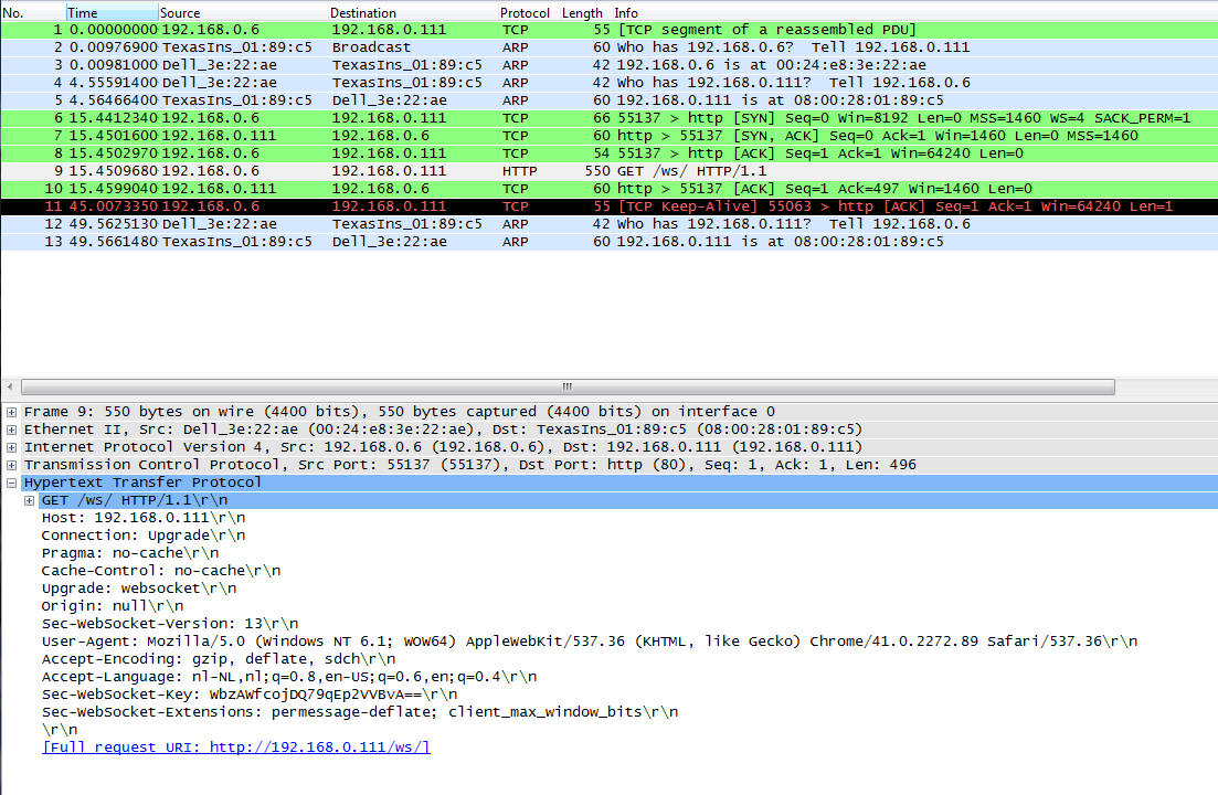

I ran following test using the CC3000 connected to a FRDM-KL25Z board :
  • CC3000 firmware and driver updated to the latest version.
  • I created a websocket client (HTML/Javascript - opened in google chrome).
  • Checked with wireshark whether the CC3000 responds to the websocket client (see picture).
  • Wireshark shows the client request and the CC3000 ACK.
When i connect the client to the CC3000, the CC3000 tells my code a connection is made but there is a lock-up, as a result, i cannot call receive (The CC3000 still responds to ping requests).
There is probably a problem with my KL25Z - CC3000 driver but, before i start debugging, i'd first like to know if the CC3000 can be used as a websocket server.

  • Update :
    First of all, it seems only IE10 sends a Websocket request (capital W), so i'll just have to add a check for this in my code (or even better: capitalize all and check against capitalized data).
    I attached the WireShark capture file :
    Frames 1..19 are captured when connecting with IE10 - packet 4 is the websocket request and gets ACKed / processed correctly.
    Frames 20..32 are captured when connecting with Google Chrome - packet 23 is the websocket request , only ACKed and a lock-up in the code (TCPSocketConnection::receive->recv is never reached).

  • SOLVED
    @_theroot : You were (partially) right, there was a driver problem, not in the websocket server code, but in the mbed CC3000 driver (shame on me).
    I should have paid more attention to the size of the websocket request headers from each browser: IE10=327 bytes, Firefox=488 bytes and Chrome=537 bytes
    The RX buffer size in the mbed code (ported from Avnet code) uses #define CC3000_MAXIMAL_RX_SIZE (511 + 1)
    As the Chrome websocket request header exceeds this value, we get a lock-up. Raising this value to 767+1 already solved the problem.
    In order to match Windows MTU (1500) i set it to TI's default value : #define CC3000_MAXIMAL_RX_SIZE (1519 + 1)
    Perhaps other users having lock-up problems also need to check whether CC3000_MAXIMAL_RX_SIZE isn't set too low?
