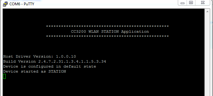

4. flashed the wlan_station project binary. Also, opened COM port, it show the following:
got the error message "Cortex_M4_0: Trouble Reading Memory Block at 0x20030008 on Page 0 of Length 0x4: Debug Port error occurred"
I can't see the full output as described in the Getting started guide for launchpad.

  • Dear Raghavendra,
    1. I flashed the wlan_station.bin using (with SOP2)
    2. Removed SOP2, reset the board. Now, the application binary starts properly. But, output is same as before ( refer to the putty screenshot in my first post).

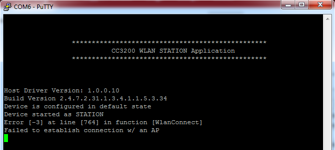

    Output is same, no progress has been made. But, when I used security type WEP, I see the following.
    Currently in the UniFlash, I use Station Addressing Scheme: Dynamic. Do I have to use the static IP option ?

  • The 3 AP details you set at common.h seems to be not your AP details, so obviously it will not connect.
    From your earlier reply, is celetra_cc3200_ap really the name of your wifi connection?
    - kel

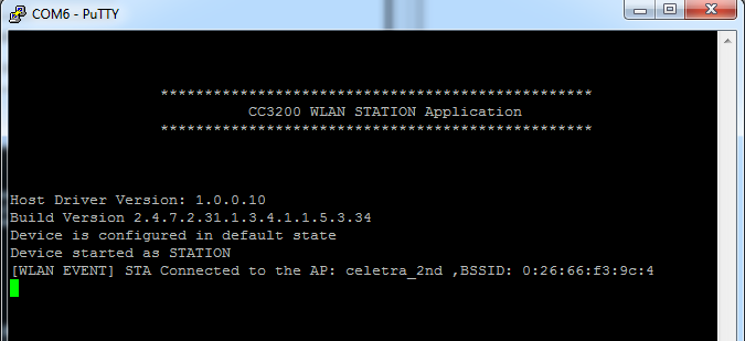

    With Session file Station Addressing Scheme: Staic or Dynamic, now, I see the following output:
    But, it is not showing as described in Getting started guide, which says, I should see something similar to the following.
    I can't see the Launchpad Mac Address ( ba:98:f7:13:49:27) in the connected wifi devices list of my WiFi router settings.
    Seems, Launchpad is unable to ping ! what could be the issue ?

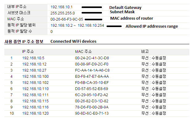

    Please have a look at the screenshot below.
    Also, Here is my WiFi router details ( also shows the connected devices).
    The launchpad is not there in the list of connected wifi devices.
    One more interesting this I see is the MAC address of the Router (BSSID) printed in the terminal as 0:26:66:f3:9c:4, but actually it is 00:26:66:f3:9c:05

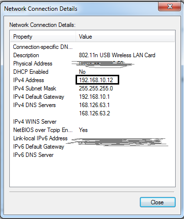

    Please check in detail if I'm doing anything wrong. Also, here is my computer network details which is connected to the same AP.
    I tried with both Static & Dynamic addressing Scheme.
    Thank you
