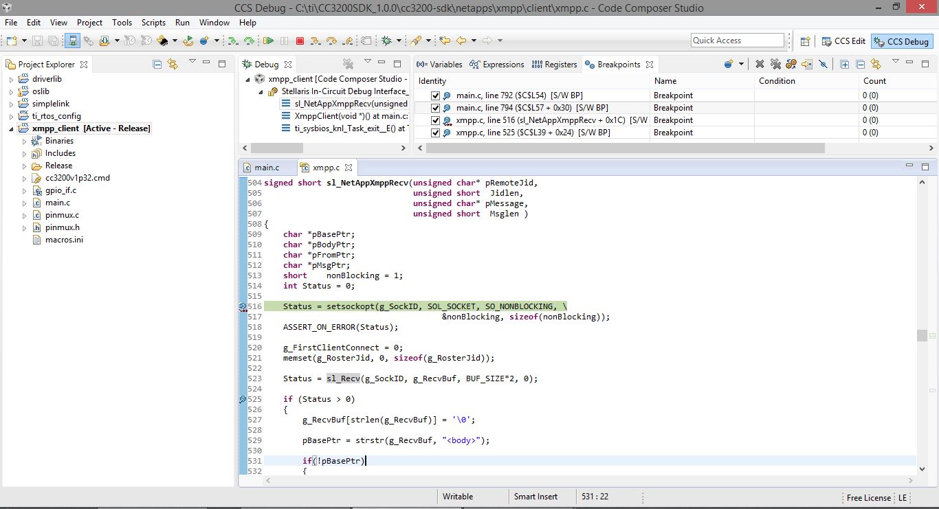

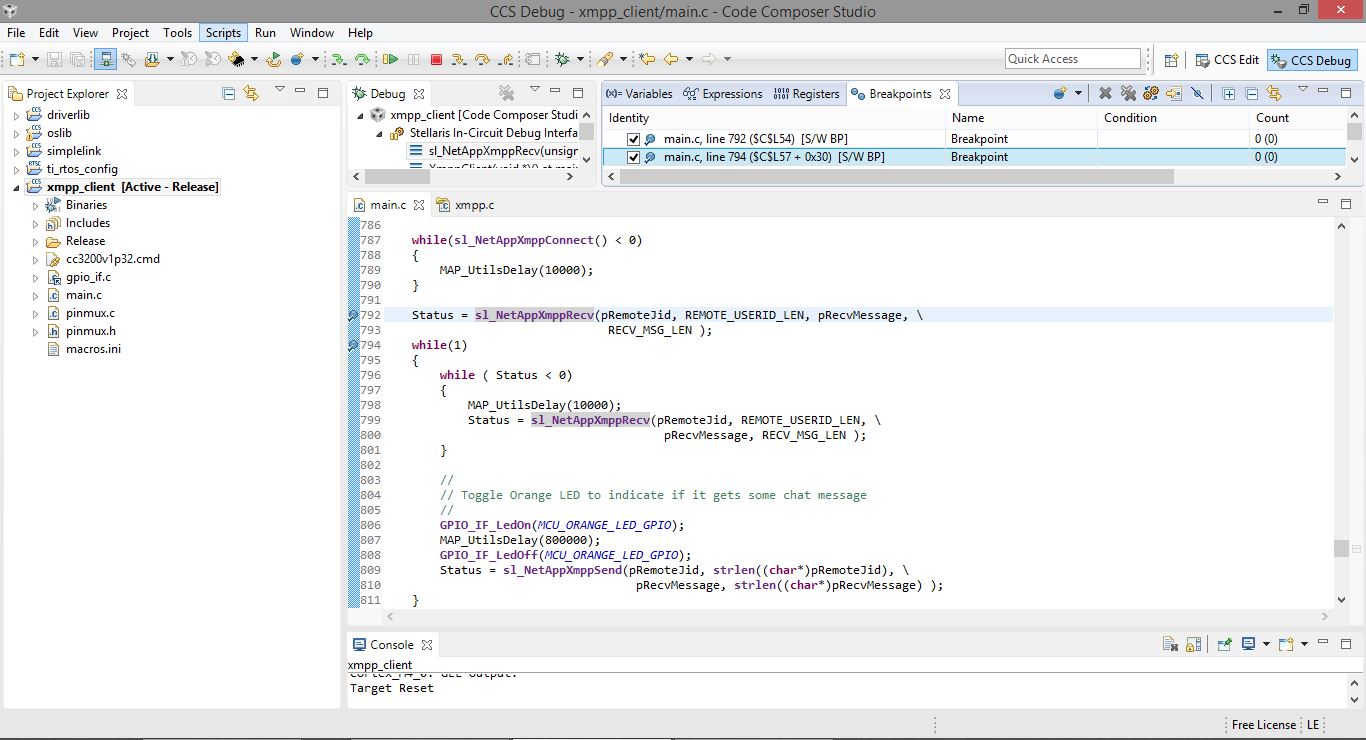

    As a first step I've placed 2 Breakpoints as in Figure 1.
    The BP at line 792 is reached. Then if I click the resume button, the BP at line 794 is never reached.
    So as a second step I added two additional BPs into sl_NetAppXmppRecv as in Figure 2.
    The BP at line 516 is reached. Then if I click on resume button the BP at line 525 is reached, showing a Status value of 1158, as in Figure 3 (please consider that at this time I'm not sending messages to the CC3200). (I tried with other debug sessions and the Status value was different, e.g. 407, 855..., always in absence of messages - is it a random value?).
    Anyway, then I expect that if I click Resume again the program would go back to the main.c, reaching the BP at line 794, since the sl_Recv (and also the sl_NetAppXmppRecv) in my opinion are completely executed.
    However, clicking on Resume button the program goes to the BP at line 516 in the xmpp.c, then at the next resume it goes at line 525 (with a Status value of -11), then again at line 516, and so on.
    It is like if the content of sl_NetAppXmppRecv function is performed infinite times, so the function never ends.
    P.S. I'd like to specify that also if I send a message to the CC3200, the content of sl_NetAppXmppRecv is repeated and the function never returns.
    Thanks for your help,
    Simone

  • Dear all,
    We have almost tryed everything (including verification of option you suggested above). We tried also with the last sdk & firmware release (including conf file) with both CCS and IAR project (provided by ti).
    Nothing is working. It seems clear to us there are problems in xmpp libraries (provided by ti).
    Could you pls try the example included in the downloadable SDK (last one) and have a look if it works for you?
    We are stuck from 2 weeks...
    If it works for you, could you please send us to a.bartolini2@gmail.com the entire working package/project you are using?(I would expect the one provided by ti).
    Hoping to let it work as soon as possible,
    Thank you,
    Alessandro Bartolini
  • Hi Alessandro,
    Can you please change macro "REMOTE_USERID_LEN" value from 50 to 100 and try.
    Aashish
  • Hi Aashish,
    we will try to modify the macro value.
    Anyway I do not understand how this would explain the loop internal to the sl_NetAppXmppRecv function that I have described in my last reply to Raghavendra.
    In fact if REMOTE_USERID_LEN was too small, then the following if:
    if (strlen(pFromPtr)+1 < Jidlen)
    internal to sl_NetAppXmppRecv would fail and the function would return with -2, isn't it?
    Instead the function never returns.
    Simone
    -11 means try again. As socket set as non-blocking and if there is no data available sl_recv -11 error code.

    sl_NetAppXmppRecv() does not get stucked.
    It simply repeats its instructions: once the end of function is reached, it starts again from the beginning and so on.
    So we can say that the main gets stucked at sl_NetAppXmppRecv call, not that the function itself gets stucked.
    About the content of g_RecvBuf buffer, in which point of the function are you interested in? Just after the sl_Recv?
    thanks for your help,
    Simone
  • Hi Aashish,
    we have modified the macro and now the program works!
    thanks for all your support
    best regards,
    Simone
