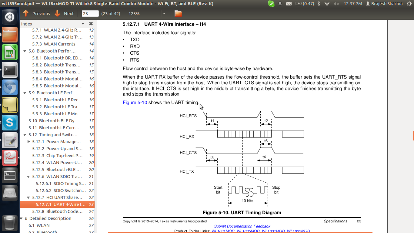

    Thanks for your prompt reply. As per your suggestions i have gone through the link that you have suggested for hardware connection and configurations. Since for now my task is to get HCI interface, I have looked in to BT Section of that link and following pin connections are required.
    HOST_TX, HOST_RX, HOST_CTS, HOST_RTS & BT_EN.
    So as i checked, i have above pins connected to WL1835MOD. But still i don't get hci0 interface in /sys/class/bluetooth/ directory.

    Yes slow clock and power is required as well, slow clock must be accurate as per the data sheet.
  • Hi Sundeep,
    As you suggested, I have checked and probed slow clock in WiLink device and it seems fine. But still it doesn't detect hci0 interface.
    Can you please check and verify the steps that i am following to get the HCI UART interface up as i explained above.

  • Hi Joseph,
    I have a query regarding HCI_UART_RTS/CTS signal. According to datasheet of WL12xx/18xx device, the valid UART transacation is done when RTS is pulled low. As shown in attachment. And according to that I can see in scope that my RTS/CTS signals are low all the time.. is that alright ? are those pins need to be high ?
    Cause in other setup that we have with WL1273, i can see the RTS/CTS lines high when the device is scanning mode(means uart transaction happening) , i can;t figure out this when it is mentioned in datasheet of 1273L that transamission needs to stop when RTS/CTS are high.
    Can you please guide me on this ?
    Brajesh
