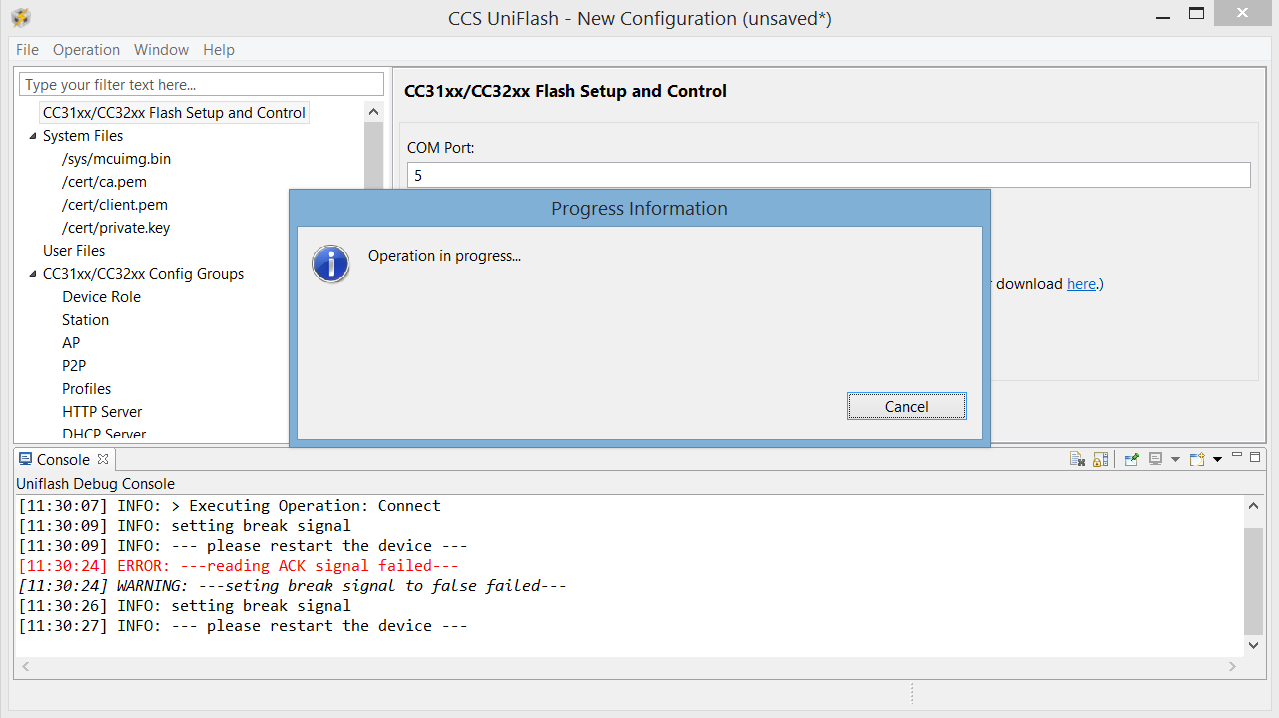

My CC3200 Simplelink Launchpad stopped working suddenly, tried to re-flash the service pack using Uniflash and didn't work, it doesn't connect with either CCS or Energia, the message I got when trying program service package using Unifalsh: Reading ACK signal failed.

(attached below screenshots of the Uniflash and CCS error messages when trying to connect with the CC3200 LP).
The initial diagnose seems it is a problem with the reset signal, but have no idea how to solve!!

Uniflash error message:
