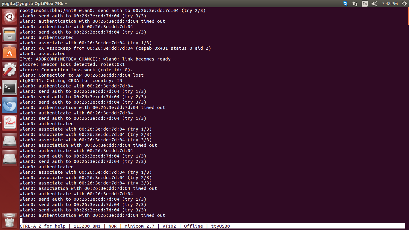

  • Hi Gigi,
    With the following configuration, I am getting wlan0 association timed out issue.
    wlan0 is getting associated and authenticated, but connection to AP is getting lost. Is there anything wrong with our configuration.
    Please find attached log.
    wpa_supplicant -Dnl80211 -iwlan0 -c /etc/wpa_supplicant.conf -B
    wpa_cli -iwlan0 disconnect
    for i in `wpa_cli -iwlan0 list_networks | grep ^[0-9] | cut -f1`; do
    wpa_cli -iw wpa_cli -iwlan0 add_network
    wpa_cli -iwlan0 set_network 0 auth_alg OPEN
    wpa_cli -iwlan0 set_network 0 key_mgmt WPA-EAP
    wpa_cli -iwlan0 set_network 0 pairwise CCMP
    wpa_cli -iwlan0 set_network 0 group CCMP
    wpa_cli -iwlan0 set_network 0 proto WPA2
    wpa_cli -iwlan0 set_network 0 eap PEAP
    wpa_cli -iwlan0 set_network 0 identity '"STC\inpsuthar"'
    wpa_cli -iwlan0 set_network 0 password '"purush2022@"'
    wpa_cli -iwlan0 set_network 0 mode 0
    wpa_cli -iwlan0 set_network 0 ssid '"STC-GOC"'
    wpa_cli -iwlan0 select_network 0
    wpa_cli -iwlan0 enable_network 0
    wpa_cli -iwlan0 reassociate
    wpa_cli -iwlan0 status
    iw wlan0 link
    udhcpc -i wlan0
    Thanks & Regards,
    Ijaz Fazily
  • Hi Ijaz,
    Which AP? I don't see any issue in the configuration. But the problem is: "Beacon loss detected". This means that the wl18xx has not received 12 successive beacons from the AP and did not receive a response to PROBE_REQ from the AP. I think this is an AP issue. Do you see this issue after you power cycle the AP Or with a different AP?
    Gigi Joseph.

    root@imx6slzbha:~# wpa_cli -iwlan0 disconnect
    OK
    root@imx6slzbha:~# for i in `wpa_cli -iwlan0 list_networks | grep ^[0-9] | cut -
    f1`; do wpa_cli -iwlan0 remove_network $i; done
    root@imx6slzbha:~#
    root@imx6slzbha:~# wpa_cli -iwlan0 add_network
    0
    root@imx6slzbha:~#
    root@imx6slzbha:~# wpa_cli -iwlan0 set_network 0 auth_alg OPEN
    OK
    root@imx6slzbha:~# wpa_cli -iwlan0 set_network 0 key_mgmt WPA-PSK
    OK
    root@imx6slzbha:~# wpa_cli -iwlan0 set_network 0 psk '"127TAg!@#sh"'
    OK
    root@imx6slzbha:~# wpa_cli -iwlan0 set_network 0 pairwise CCMP TKIP
    OK
    root@imx6slzbha:~# wpa_cli -iwlan0 set_network 0 group CCMP TKIP
    OK
    root@imx6slzbha:~#
    root@imx6slzbha:~# wpa_cli -iwlan0 set_network 0 mode 0
    OK
    root@imx6slzbha:~#
    root@imx6slzbha:~# wpa_cli -iwlan0 set_network 0 ssid '"VVDN_AP"'
    OK
    root@imx6slzbha:~#
    root@imx6slzbha:~# wpa_cli -iwlan0 select_network 0
    wlan0: authenticate with a4:4c:11:ee:ed:a5
    wlan0: send auth to a4:4c:11:ee:ed:a5 (try 1/3)
    OK
    root@imx6slzbha:~#
    root@imx6slzbha:~# wlan0: send auth to a4:4c:11:ee:ed:a5 (try 2/3)
    wlan0: send auth to a4:4c:11:ee:ed:a5 (try 3/3)
    wlan0: authentication with a4:4c:11:ee:ed:a5 timed out
    wlan0: direct probe to a4:4c:11:ee:ed:a5 (try 1/3)
    wlan0: direct probe to a4:4c:11:ee:ed:a5 (try 2/3)
    wlan0: direct probe to a4:4c:11:ee:ed:a5 (try 3/3)
    root@imx6slzbha:~# wlan0: authenticate with a4:4c:11:ee:ed:a5
    root@imx6slzbha:~#
    root@imx6slzbha:~# wpa_cli -iwlan0 enable_network 0
    OK
    root@imx6slzbha:~#
    root@imx6slzbha:~#
    root@imx6slzbha:~# wpa_cli -iwlan0 reassociate
    OK
    root@imx6slzbha:~#
    root@imx6slzbha:~#
    root@imx6slzbha:~#
    root@imx6slzbha:~#
    root@imx6slzbha:~#
    root@imx6slzbha:~#
    root@imx6slzbha:~# wpa_cli -iwlan0 status
    wpa_state=SCANNING
    address=78:a5:04:20:fa:a3
    root@imx6slzbha:~#
    root@imx6slzbha:~#

  • Hi Ijaz,
    Can you share an air sniffer log for this issue?
    Gigi Joseph.
  • Hi Gigi,
    This issue is fixed now with proper calibration steps.
