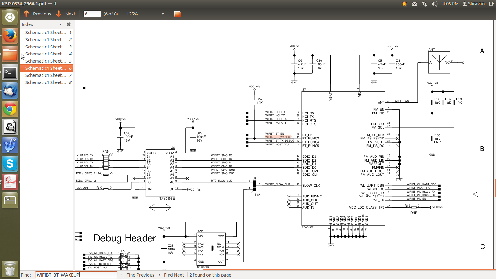

  • Hi Joseph,
    The above link do not show the required bts file "TIInit_7.2.31.bts"
    Although I got the file from processors.wiki.ti.com/.../e8
    But still the current log shows...
    root@GE-AM335x:~ hciattach /dev/ttyO1 texas 3000000
    Found a Texas Instruments' chip!
    Firmware file : /lib/firmware/TIInit_7.2.31.bts
    Loaded BTS script version 1
    texas: changing baud rate to 3000000, flow control to 1
    Initialization timed out.
    root@GE-AM335x:~ hciconfig
    hci0:   Type: BR/EDR  Bus: UART
            BD Address: 00:00:00:00:00:00  ACL MTU: 0:0  SCO MTU: 0:0
            DOWN
            RX bytes:0 acl:0 sco:0 events:0 errors:0
            TX bytes:0 acl:0 sco:0 commands:0 errors:0
    I am attaching the relevant screenshot schematic of my board in reference to TI. Please help us to verify the same.
    Project deadlines are near, your help is highly appreciable.
    shravan.

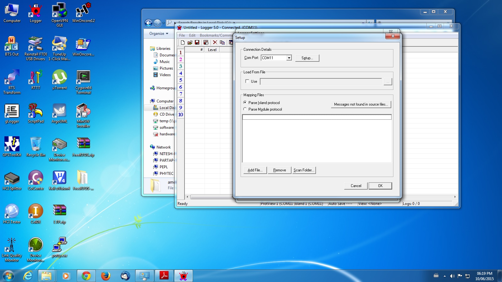

  • Hi Gigi,
    I have downloaded the logger tool and installed successfully, now while doing the configuration/setting it is asking for mapping file ( with extension .ili i.e. parse island protocol) , attached image for your reference.
    Please help me to close this blocking issue ASAP.
    shravan.
    Please see: git.ti.com/.../master
    Gigi Joseph.

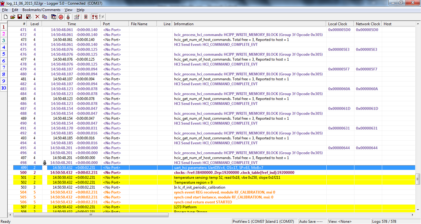

  • Dear Gigi
    Now  logs are coming by changing the port no to 2.
     logs  given below for your troubleshooting.
    Thanks for your help.
    Shravan

  • Hi Gigi
    On changing port no logs are coming fine.
    Attached the logs for your troubleshooting....
    Shravan
