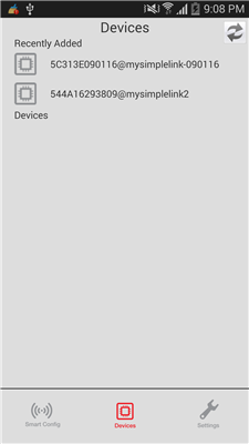

I can see all three LEDs ( D5, D6, D7 ) are ON. Just after power on, D5, D6 are ON, red LED glows few seconds after.

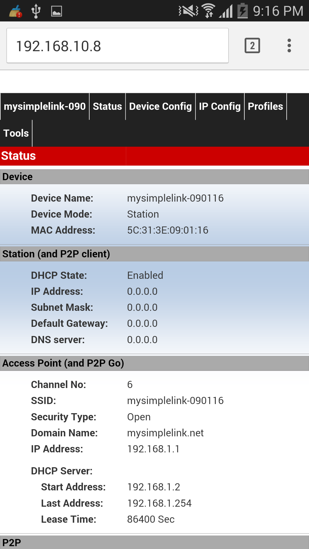

Open Wi-Fi Starter App on my Android S4 smartphone, Enter my office WiFi AP details ( Network Name: SSID, Password: xxxxxx). This AP has WPA2 security.
If I click on these names, the settings are opened in browser, but both launchpads webpage looks different.
Please advice what to do from here on. I'm pretty sure on the hardware side steps like to on/off the Line-IN and Line-OUT etc... Unable to figure out from here on, how to configure these two launchpads to execute the demo.
    That's ok it showing default webpage. But it confirmed both the device connected to AP.
    As soon as device connected to each other devices switch from loopback mode to streaming mode means mic-in on one device to audio-out on another device.  To start audio streaming Press SW3 on on device and SW2 on another device. For more details please refer "Audio Streamer/Player" section on http://processors.wiki.ti.com/index.php/CC32xx_Wifi_Audio_Application

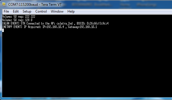

  • Dear Aashish,

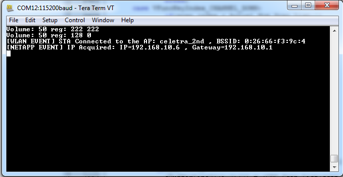

    I see the following in terminal when I press SW2 on launchpad1.
    Orange & Red LEDs are ON.
    launchpad1 Terminal output:
    launchpad2 Terminal output:
    On launchpad 2, After I press SW3, The gree LED is ON.
    Is there any problem in my UniFlash session file Station Config ?
    Thank you.

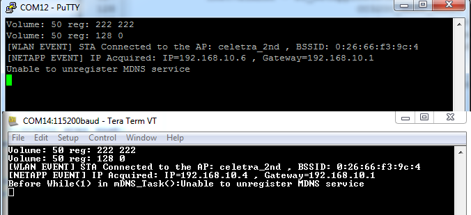

  • I'm still unable to get this work. I attached screenshots to demonstrate how I'm using Uniflash for flashing binary.
    Uniflash.zip
    Please let me know If I'm doing something wrong !
    Also, will there be any issue of router settings in this case ? For example, port forwarding  ?
    The terminal shows Unable to unregister MDNS service
    First t is unable to unregister. So it can't register, hence the problem.

  • Hi Hari,
    Sorry I misread the log "Unable to unregister MDNS service" not "Unable to register MDNS service". So that's ok, it failing to unregister the service.
    Hari C said:
    if(lRetVal < 0) { UART_PRINT("Unable to register MDNS service\n\r"); LOOP_FOREVER(); }
    Put a log message in else part to indicate whether it able to registered or not. Also put a log message in mDNS_Task() after "g_loopback = 0;" to verify the same.
    Aashish

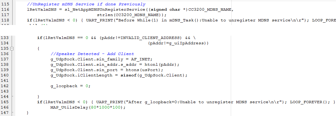

  • Hi Hari,
    I mean following way:
           if(lRetValmDNS == 0 && (pAddr!=INVALID_CLIENT_ADDRESS) && \
                                                    (pAddr!=g_uiIpAddress))
                //Speaker Detected - Add Client
                g_UdpSock.Client.sin_family = AF_INET;
                g_UdpSock.Client.sin_addr.s_addr = htonl(pAddr);
                g_UdpSock.Client.sin_port = htons(usPort);
                g_UdpSock.iClientLength = sizeof(g_UdpSock.Client);
                g_loopback = 0;
                UART_PRINT("LP1 connected to LP2\n\r");
    And don't use LOOP_FOREVER();
    Aashish

  • Here is the modified example project source.
    1256.wifi_audio_app.zip
  • Hi Hari,
    Please replace following code
    if(lRetValmDNS < 0) { UART_PRINT("Before While(1) in mDNS_Task():Unable to unregister MDNS service\n\r"); LOOP_FOREVER(); }
    with
    if(lRetValmDNS < 0) { UART_PRINT("Before While(1) in mDNS_Task():Unable to unregister MDNS service\n\r"); }
    Please don't use LOOP_FOREVER().

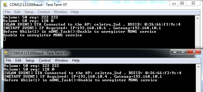

  • Sorry for that mistake about LOOP_FOREVER()
    Here is the requested log. Still the problem is same.
    Thank you
  • Hi Hari,
    From log it seems you pressed SW2 on one board and SW3 on another board only. You need to do same operation other way also.
    LP1- SW2 LP2-SW3
    LP2-SW2 LP1-SW3
    Aashish

    We also have the same issue & tried all the above steps.
    We have also removed LOOP_FOREVER(), but still one board is stuck with "Unable to unregister from MDNS service"
    The other board shows Launchpad1 connected to Launchpad2 & the audio streaming is not working.
    -Abrar
  • Hi Ashish,
    I am a colleague of Abrar,
    We tried the modifiactions sugggested in the link processors.wiki.ti.com/.../CC32xx_Summary_of_Known_Issues.
    But still we see Unable to unregister MDNS service.
    Can we get SDK 1.0.0 As we didnt run this application sucessfully till now with 1.1.0.
    Bhargav.
