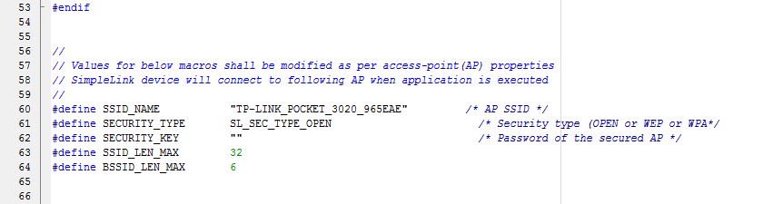

    I have tried again with Dongle of one mobile service provider Which doesn't require proxy settings. But Still there was problem and on Tera Term Screen it is shown like "Error [-2001] at line [731] in function [CheckInternetConnection]   , Device couldn't ping the external host". For this i have written this code block for internet access ,

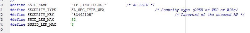

    #define SSID_NAME           "TP-LINK_POCKET_3020_965EAE"    /* AP SSID */
    #define SECURITY_TYPE       SL_SEC_TYPE_OPEN                /* Security type (OPEN or WEP or WPA*/
    #define SECURITY_KEY        ""                              /* Password of the secured AP */
    Here, I am using TP-LINK wifi router  for access point. I have plugged in Dongle in this wifi router. I also checked Mobile, I have made mobile as HotSpot nd there was also no security and no password.But there was also the same problem. It is not going forward.

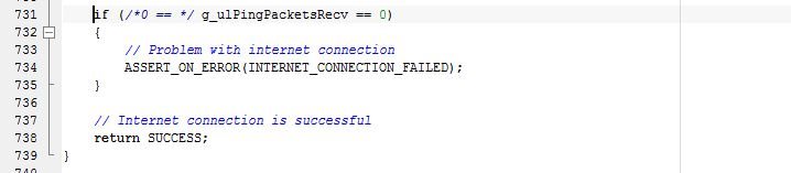

    The error is coming in line no. [731] of [CheckInternetConnection] function of  main.c of  [getting_started_with_wlan_station] example of CC3200-SDK.
    The pointer is getting into IF statement because of  variable "g_ulPingPacketsRecv" is having value '0' and variable  'g_ulPingPacketsRecv' is Number of Ping Packets received.
    Whole IF statement is like this :
    if (0 == g_ulPingPacketsRecv)
    // Problem with internet connection
    ASSERT_ON_ERROR(INTERNET_CONNECTION_FAILED);              <-- Line No. 731
    The error is [-2001], i.e. (-7D0-1)  in hex.

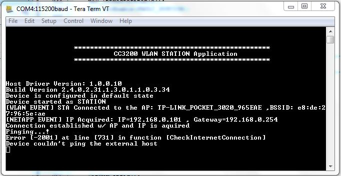

  • Hi TI,
    I am working with CC3200 in IAR Embedded Workbench for ARM 7.40 and testing a “getting_started_with_wlan_station”code whose explanation is given in video, whose link i have mentioned below. I correctly followed all the steps mentioned in video.But i don't know why the error is coming?
    First image explains the SSID NAME, SECURITY TYPE and PASSWORD.
    Second image explains the error displayed on TERA TERM.
    Third image explains the error function CheckInternetConnection() along with line where error is stuck.
    Please help me. I have been facing this problem since last one month. Its urgent to solve this error.
    Thanking you in advance.
    Link for Video : www.youtube.com/watch?v=oian8iwg2jQ

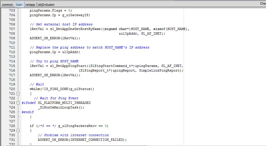

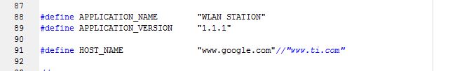

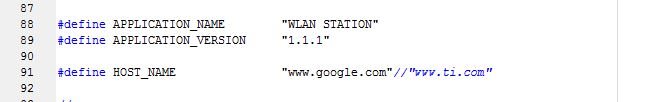

  • Hi Ankit,
    Just to confirm that you haven't modified anything in the example (except the AP credential information).
    Can you please try following test?
    1) Change the 'HOST_NAME' macro value to "www.google.com" and test the example.
    2) Try running the application in the debug mode and verify the IP received by the 'sl_NetAppDnsGetHostByName()' API.
    Ankur
  • Hi Ankur,
    Thank you for answering my question.
    I would like to share updated output when i changed 'HOST_NAME' and ran in debug mode.
                              CC3200 WLAN STATION Application
    Host Driver Version: 1.0.0.10
    Build Version 2.4.0.2.31.1.3.0.1.1.0.3.34
    Device is configured in default state
    Device started as STATION
    [WLAN EVENT] STA Connected to the AP: TP-LINK_POCKET_3020_965EAE ,BSSID: e8:de:27:96:5e:ae
    [NETAPP EVENT] IP Acquired: IP=192.168.0.101 , Gateway=192.168.0.254
    Connection established w/ AP and IP is aquired
    Pinging...!
    --> I am using dongle of one mobile service provider. To make AP , i have plugged it into wi-fi router (setup's image has been attached). So now what should i do to troubleshoot this problem?
    -->Sir, can you please help me in printing value of 'lRetVal' on Tera Term? I tried with UART_PRINT but it seems to print  string only.
    If i can print 'lRetVal' then it may become easy to analyse.
    -->Please Guide me.
    Thanking you.
    Ankit
  • Hi Ankit,
    As I requested please verify the IP received by 'sl_NetAppDnsGetHostByName()' function. You can put the breakpoint just after this function call and check the value in 'ulIpAddr' variable.
    Also please share if you have made any changes at the code/logic level in the example.
    You can use the 'Report()' function to print the values (behaves similar to printf)
    Ankur

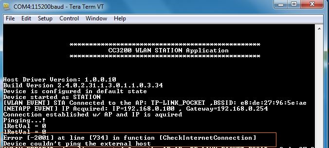

  • Hello Sir,
    I have placed breakpoint after 'sl_NetAppDnsGetHostByName()' function and watched values of various variable. Watch window has been attached.
    The output on Tera Term is:
    [WLAN EVENT] STA Connected to the AP: TP-LINK_POCKET ,BSSID: e8:de:27:96:5e:ae
    [NETAPP EVENT] IP Acquired: IP=192.168.0.100 , Gateway=192.168.0.254
    Pinging...!
    lRetVal = 0
    lRetVal = 0
    Error [-2001] at line [734] in function [CheckInternetConnection]
    Kindly suggest me for further test.
  • Hi TI,
    As i posted questions regarding problem in CC3200 getting started Wlan Station example code. (Link :   https://e2e.ti.com/support/wireless_connectivity/f/968/p/416313/1526355#1526355 )
    In that i am trying to get 'External Host IP Address' (Image has been attached).
    So can you please tell me how to convert integer format value to network format value in CC3200 getting started wlan station example code?
    I want to read IP Address acquired at line no. 707.
    Please Guide me.
    Ankit

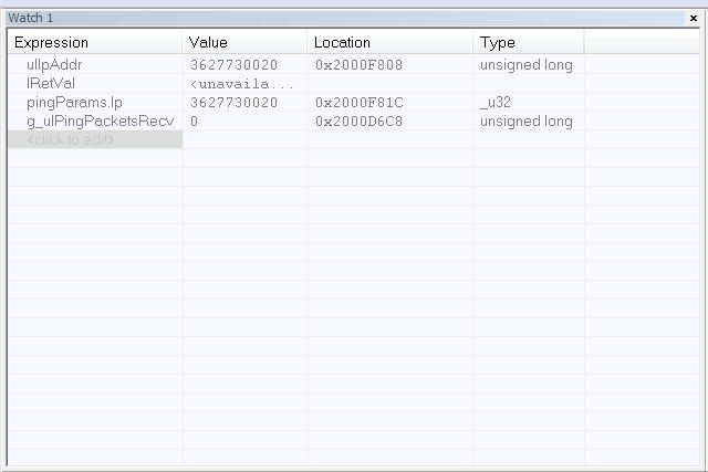

  • Hi Ankit,
        The IP address is stored at unsigned long ulIpAddr. Do you mean to convert the value to IP address with a dot separator like this 172.16.254.1?
        It is not that hard. Seeing the link below will give you an idea how. But, probably you can get sample codes for that in the internet.
        IP address
    - kel
  • Hi Kel,
    Many many thanks for replying my post.
    I got online to convert an unsigned int value to an IPV4 address.
    my application is to push signal on  ti.exosite.com in real time. For that i have to perform ADC for this.
    so i am testing 'getting started wlan station' example. To perform this test i am using Dongle of one mobile service provider. The reason for using dongle is, it is said to open network, no proxy restriction is there.
    When i perform test , error comes like 'Device couldn't ping the external host'. I don't know why this error is coming.
    I am placing few snapshot taken today while performing test.
    In main.c file, i have placed two breakpoints one at line no. 710 and other at line no.717
    According to 3627729924, IPV4 address is : 216.58.196.4  ( Link )
    According to 3232235774, IPV4 address is : 192.168.0.254 ( Link )
    How to find PORT no. through which whole communication is being established, because i suspect there might be issue regarding port no.
    Can you please help me?
