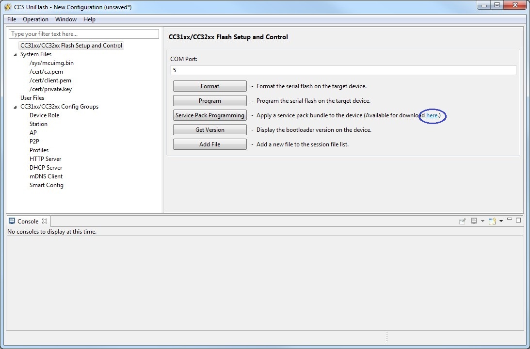

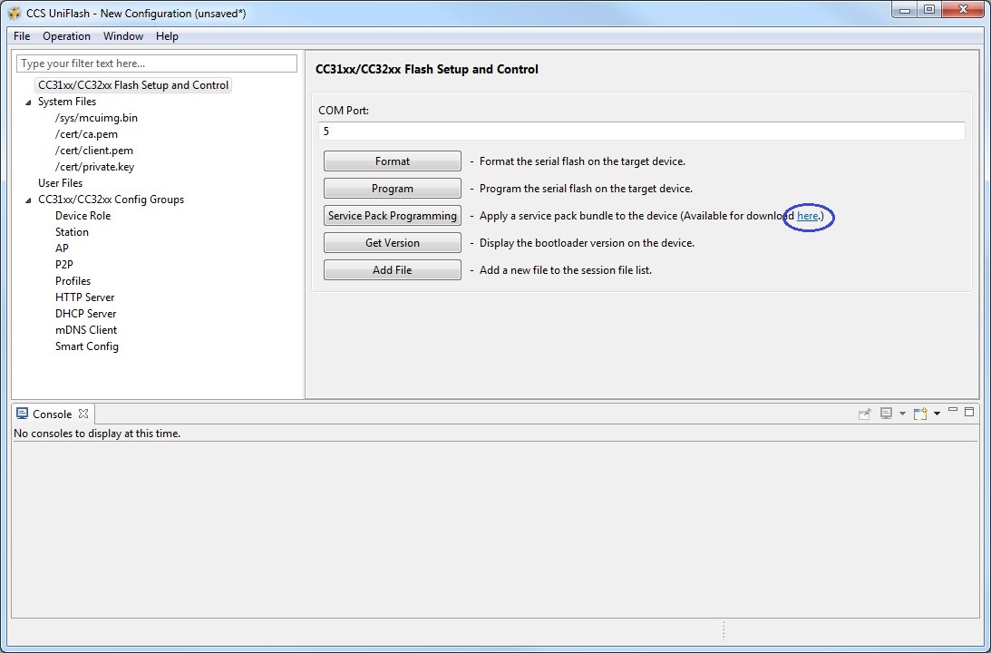

  • Teun,
    You picked a wrong service pack file.
    You need to pick the service pack binary from the service pack installation. There is a link to it in Uniflash next to the button.
    In you case you tried another file which explains the bundle error.
    C:/ti/CC3200SDK_1.1.0/cc3200-sdk/example/out_of_box/ccs/.ccsproject
    Shlomi
  • Hello ShIomi,
    Thank for your answer! Using Uniflash the project file I have to use, you said, is: C:/ti/CC3200SDK_1.1.0/cc3200-sdk/example/out_of_box/ccs/.ccsproject.? Is this the same as to use in CCS? Is that right?
    I tried that before. But you said I had to first do: ‘”You need to pick the service pack binary from the service pack installation.””
    C:\TI\CC31xx_CC32xx_ServicePack_1.0.0.10.0\servicepack_1.0.0.10.0 BINbestand .
    You said now there is a link to it in Uniflash next to the button. I cannot find it, what do you exactly mean? Where can I find this to place the upgrade? And if I understand you right, do I have to do the same service pack upgrade for CCS?
    Thanks again,
    Teun
  • Teun,
    What you need to do in Uniflash is to update the service pack.
    On Uniflash, there is a link to download the service pack (see picture below).
    Just click on 'Service Pack Update' and choose servicepack_1.0.0.10.0.bin.
    Shlomi
