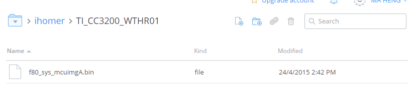

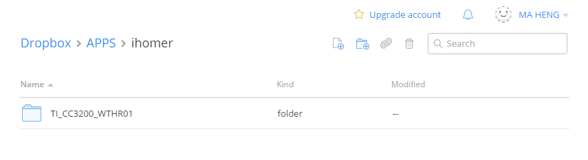

I am trying to add OTA function in getweather app.
I followed all steps in the section 5 of the tutorial.

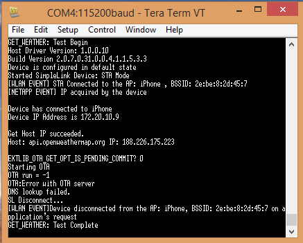

However, I got the following message indicating the error.
Anyone know how to solve it,
Heng

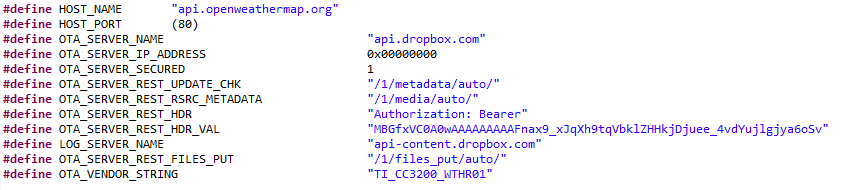

Sorry, I could see that you are able to get the IP address of the remote host. You need not try the test with getting_started_with_wlan_station example.
Could you please verify the configuration in otaconfig.h? The section 4 in the same application note explains the configurations.
