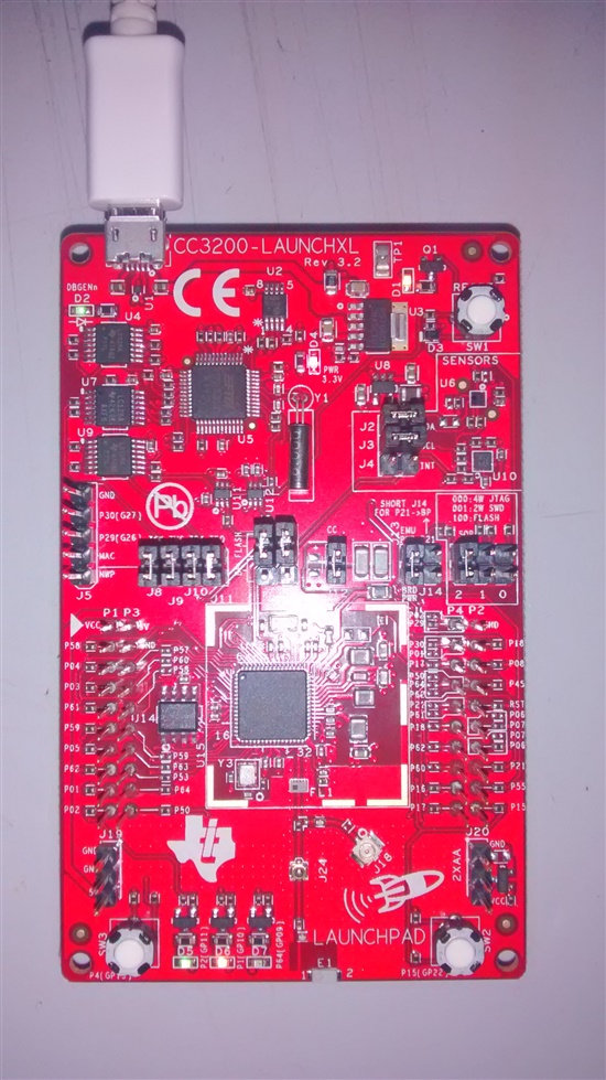

Hello
I am using CC3200 rev3.2 board service pack version i believe I was using 1.0.0.1.2 (not sure/tell me how to check?). I was using it wonderfully for weeks and then did not use it for sometime and when I started working on it again it isn't working. I am using CCS 6.0.1.00040 and Uniflash 3.2.0.00120 software to work with it. Checked jumper settings, changed PC, reboot the PC, COM port not used by other application, pressing button when asked to, all checked. But the problem is still there. At last also tried Energia software with different jumper settings but seems like a dead end.
Voltage levels with multimeter are correct. D1 LED goes down when pressed reset button correct. Please help.
Uniflash logs for format operation(At last a error message: Can't connect to device.):

CCS logs for debugging operation(At last a error message: Error connecting to the target.):
Cortex_M4_0: GEL Output:
Memory Map Initialization Complete
Cortex_M4_0: Error connecting to the target
Jumper Settings exactly same as in this pic:
