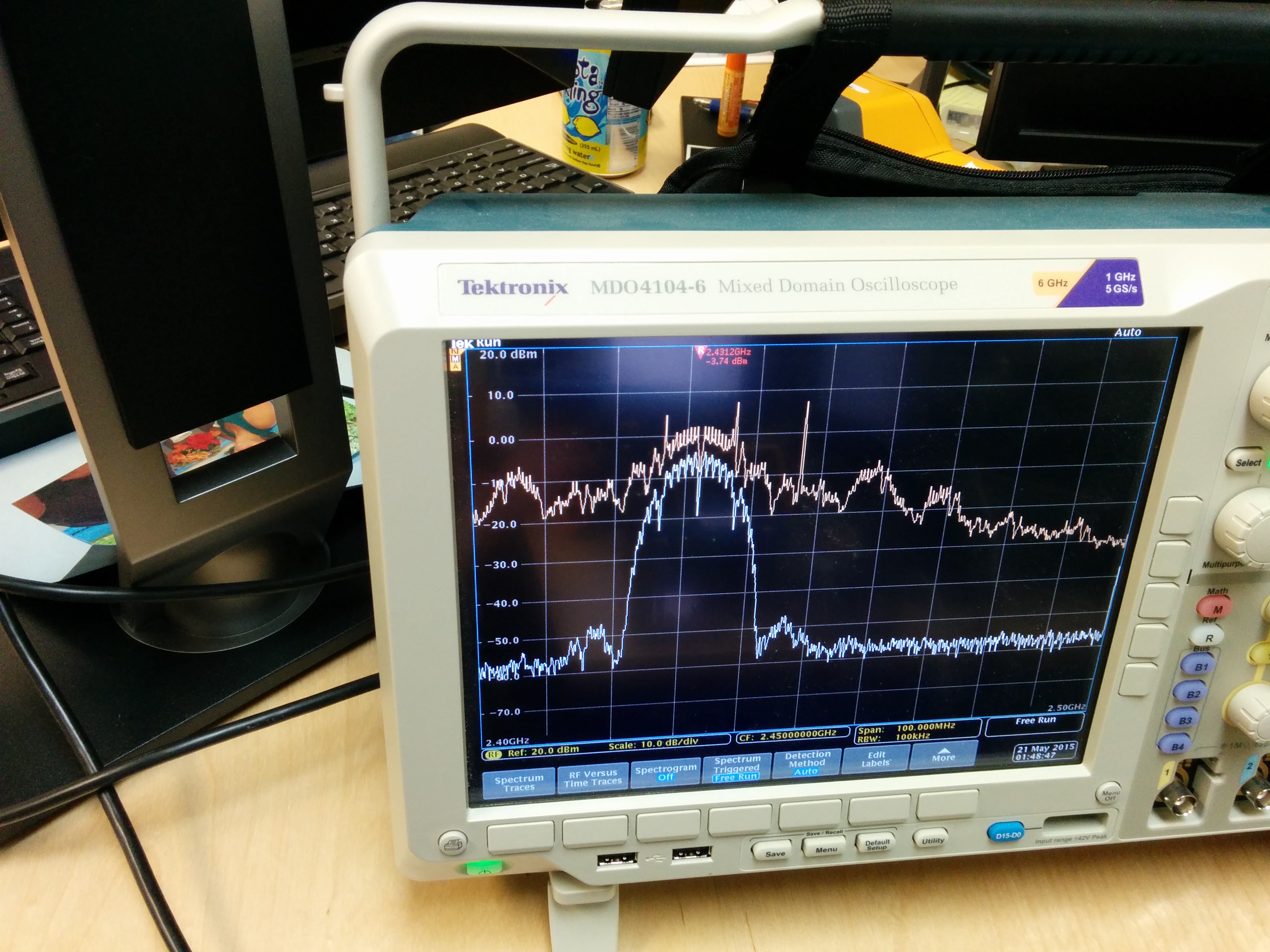

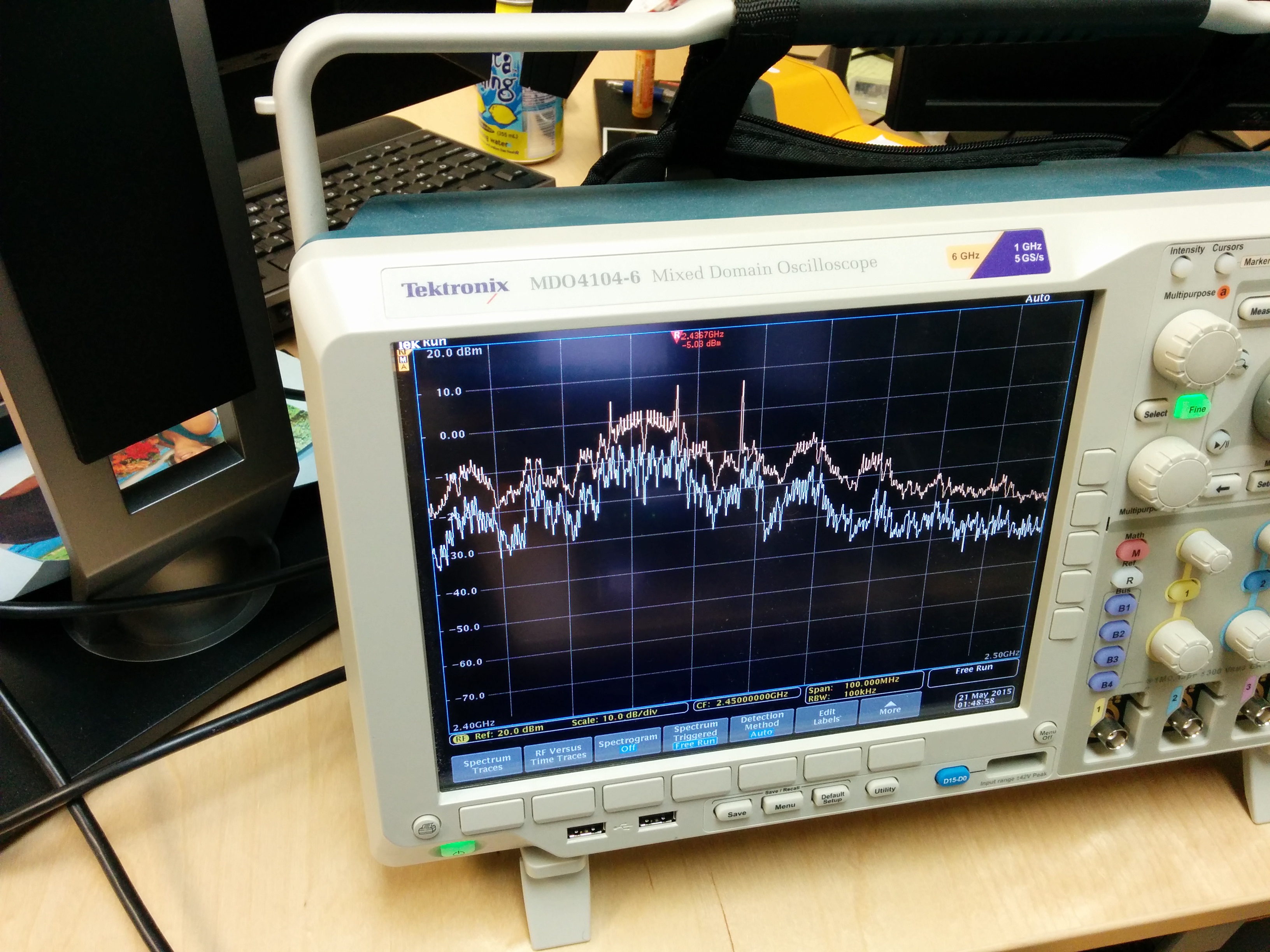

I'm hoping for some guidance to figure out what is going wrong in our setup.
System is DM3730 running Linux with a wl18xx module.  We can send tx_start commands using calibrator, but always at Wifi channel 5 the output goes haywire and the module doesn't seem to recover until power is cycled.  I'm asking for areas to look to troubleshoot the problem.  Obviously there is enough working that the path from wifi->calibrator->driver->firmware works.  But something is misconfigured somehow.  What other information can I provide?
We have a script that calls calibrator (0.8) like so:
# ./wifi 5 1
Calibrator:: Stopping RX Simulation
Calibrator:: Stopping TX Tone
Cycle Delay = 200 usec
Calibrator:: Starting TX Simulation (delay=200, rate=0, size=2000, mode=0
                                     data_type=0, BW=0, gi=0, opt1=0x0, opt2=0x0
                                     src=11:22:33:44:55:66
                                     dst=11:22:33:44:55:77)...
Good output for a lower channel is shown in the first attachment and bad output for channel 5 is the second attachment.
