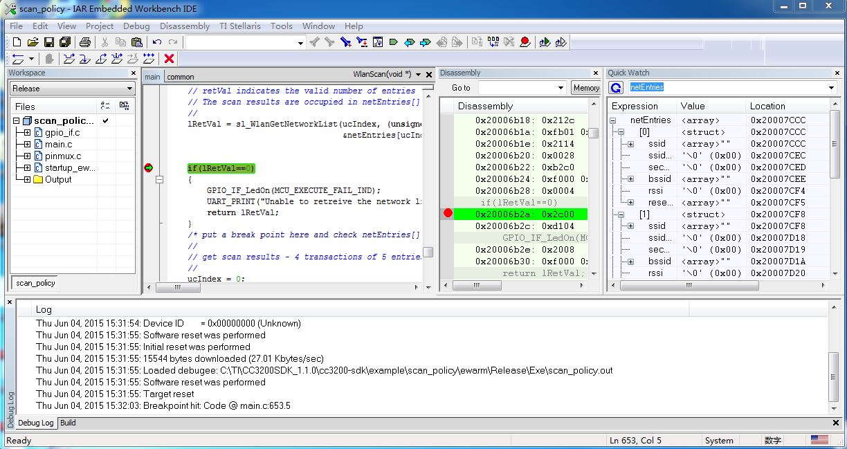

    Then i use IAR 7.30 to debug the program "scan policy".
    After "lRetVal=sl_WlanGetNetworkList()" i make a breakpoint, then debug it and observe the value of netEntries. I get the value of  IRetVal which is the returned value from the fuction, it is 0. That means, the chip 3200 has not found any signal nearby. But i have opened two routers nearby. This is a shortcut for it.
    Maybe that is just the problem. CC3200 can not find any singal, and certainly can not work as a AP or as a Station.
    Could you give me some suggestions about it ? Or maybe i should change to another CC3200 ? This chip is not mine, but from my school.
    Did you step through all the iterations? I would suggest that you print the list of APs that are available.
    Cannot really comment if this is an issue with the signal or not, because in the AP mode, the station was able to scan the CC3200.
    Raghavendra
    I have tried to use scan_policy to scan the available APs nearby. But it shows nothing. That is the result.
    After the function i should see the SSID of my router in "Quick Watch". But obviously nothing there.
    Zhang Jia Yi
