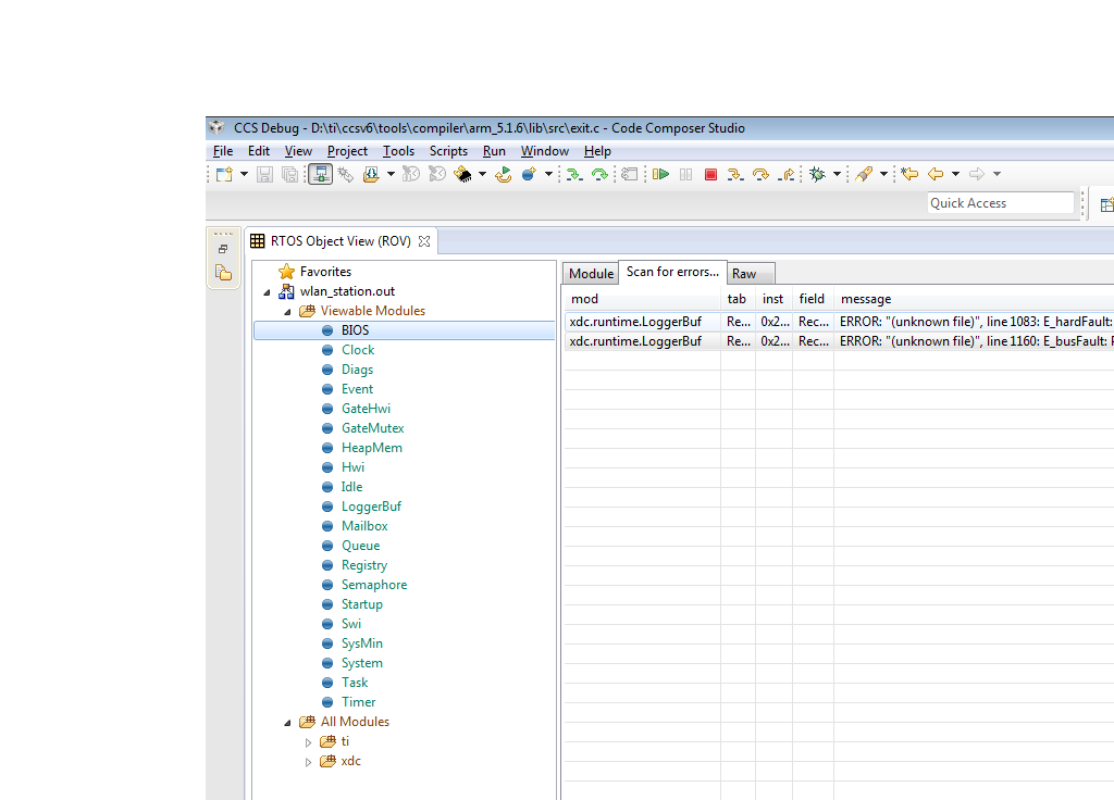

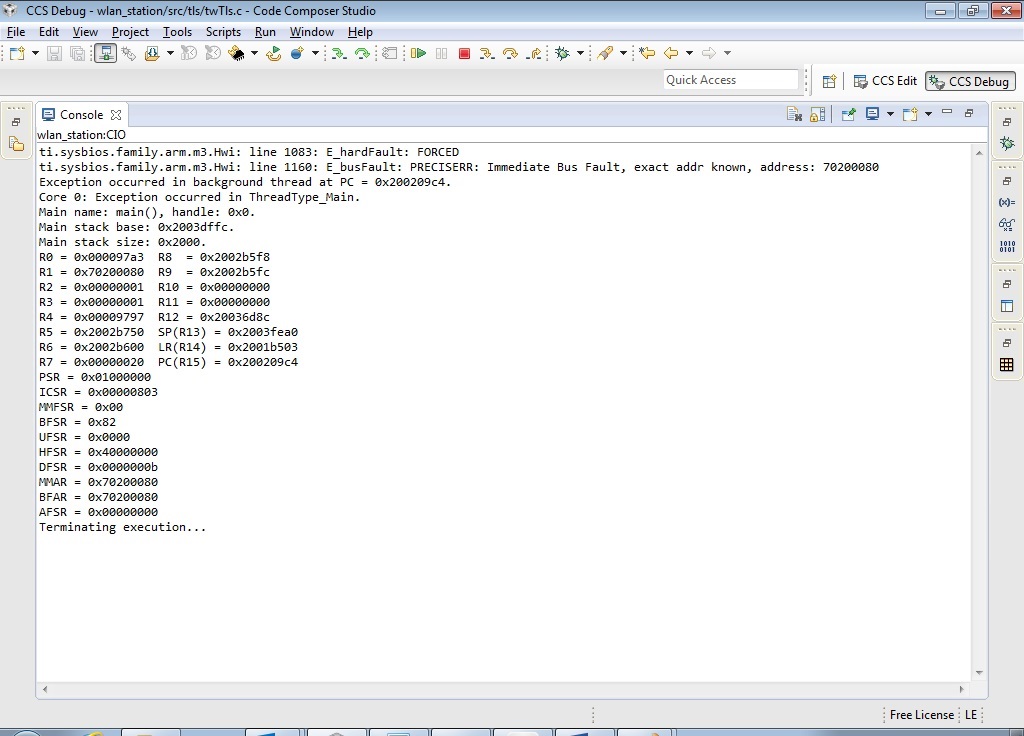

We are using the CC3200 to develop IOT applications.
The code base which we want to deploy on these boards is bit big and it appears the issues we are getting is due to this.
Attached is the image of the issue we are facing. Please help us resolve the issue.

  • Hi Shreepriya,
    You can interface an external RAM but you would not be able to execute anything from that.
    Regarding the TI RTOS issue, hard to comment as I am not sure about what your code is doing. But please check whether you have provided enough stack size in "System configuration" in .cfg file , and also please check whether enough heap is provided in "BIOS configuration".

    On the build we are using the WLAN station project and on top of it we have added our code as we want the WIFI connection.
    In this project we don't see the configuration file, so should we create a new configuration file and add all the functionality.
    When we tried creating configuration file I was not able to open it in XCONFG editor.

  • Hi Shreepriya,
    You can use the RAM to store the data section. But the execution would slow down, the bottleneck would be the speed at which the interface is operating at.
    If you have started from the basic getting started application, then you would find the .cfg file under 'cc3200-sdk\ti_rtos\ti_rtos_config'.
    Please take a look at this file for relevant configurations.

  • Hi Sreepriya,
    What maximum stack and heap size use by your application.
