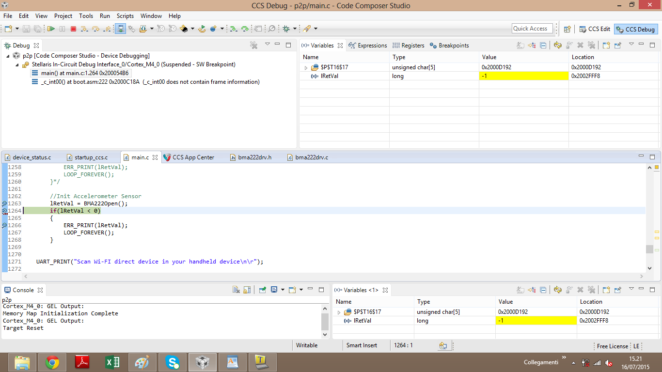

Hi to everybody ,
I have an error when I try to enable the accelerometer inside the board
//Init Accelerometer Sensor
lRetVal = BMA222Open();
if(lRetVal < 0)
ERR_PRINT(lRetVal);
LOOP_FOREVER();
I put both jumper on the J2 (SDA) and J3 ( SCL) .
I need to do other things ??

  • Hi Luca,
    What is the status of J2/J3 jumpers? Please see the CC3200 Launch Pad user guide section 2.4.2 at: processors.wiki.ti.com/.../CC32xx_LaunchPad_Hardware
    Gigi Joseph.
  • Hi Gigi ,
    I put a jumber on j2 and j3..
    I think it is ok..
    it is correct ?
    Luca
  • Hi Luca,
    Yes, are you able to run the out of box demo? It has a scenario involving the accelerometer.
    Are you calling I2C_IF_Open() ?
    Gigi Joseph.

  • Hi to everybody ,
    I am trying to use the accelerometer for a my application but i have an error ( read from I2C FAILDED)..
    I tried the out of box example application and I don't have this error.
    Why is there this error in mine ??

  • Hi to everybody ,
    I have a problem when I try to enable the accelerometer..
    I tried a lot things but I can't solve..
    Do you have some possible solutions ??
    Thanks  A lot
  • Hi Luca, please make sure you have the correct pinmux configuration. You can copy this from out of box as well.
    -Aaron
  • Hi Aaron ,
    You have solved the problem.. I didn't check the pinmux file because it had the same name and I thought the configuration was the same for each test..
    Now I can try to use the sensors..

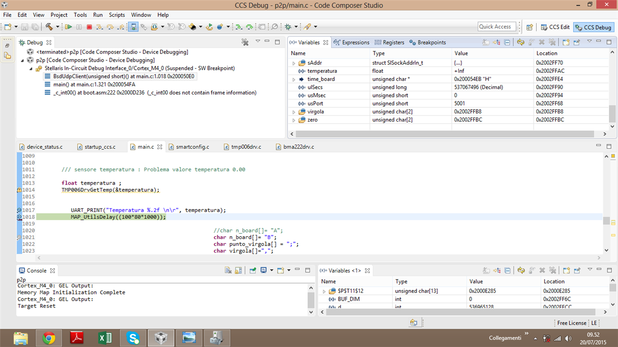

  • Hi Aaron ,
    I tried with the temperature sensor..
    float temperatura ;
    TMP006DrvGetTemp(&temperatura);
    UART_PRINT("Temperatura %ld ", temperatura);
    The value on the terminal is :  544210944
    what does it mean ?? It is a strange value for the temperature
  • I modified with
    UART_PRINT("Temperatura %.2f \n\r", temperatura);
    but the value for the temperatur is always 0,00
    why ??? :(
  • What does the entire temperature read sequence look like?

  • Please post the rest of the code
  • HI Aaron ,
    the main :

    And inside the udp client function I add :
    float temperatura ;

    The value for the temperature after the calling of TMP006DrvGetTemp(&temperatura) function is + Inf..
    What is the mistake ?
  • Luca,
    What is the warning for the call to TMP006DrvGetTemp?
    -Aaron
  • What do yuo mean with warning ?? i need to pass a pointer to a float for this function..
    Luca
  • That line is underlined in yellow...
  • Hi ,
    I can' t see this line.. Where is it ?
    Best Regards
              Luca Rossini
  • In your code, the yellow underline indicates a warning
    -Aaron
