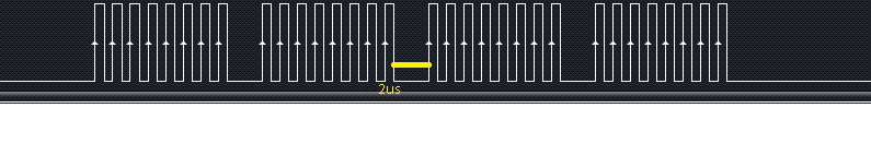

    For helping, I update some value information for the issue. I think some problems in cc3100 are the reason of the issue
    I have check in Logic analyst to investigate what it is. I found than After send the Sync Word (Host to device,Read: 0x8765567x ) CC3100 doesn't send the SyncWord(0xABCDDCBx ).
    Please check It and confirm about the issue.
    The bellow is the capture of logic analyst. I also attach the logic analyst data. You can download and install logic analyst at here
    Thanks and best regards,
    Kevin

    I make me think about there
    -  Might CC26500 SPI DMA dump data to fast -> CC3100 missing something from host ?
    - SPI connection is not good between SmartRF06 board <-> CC3100
    I need an confirm from TI about the interval between 2 bunch clock of two bytes
    In my case, the interval is 2 us.
    Really hard to debug the issue. Appreciate with any infor
    THank and best regards,
    Kevin
