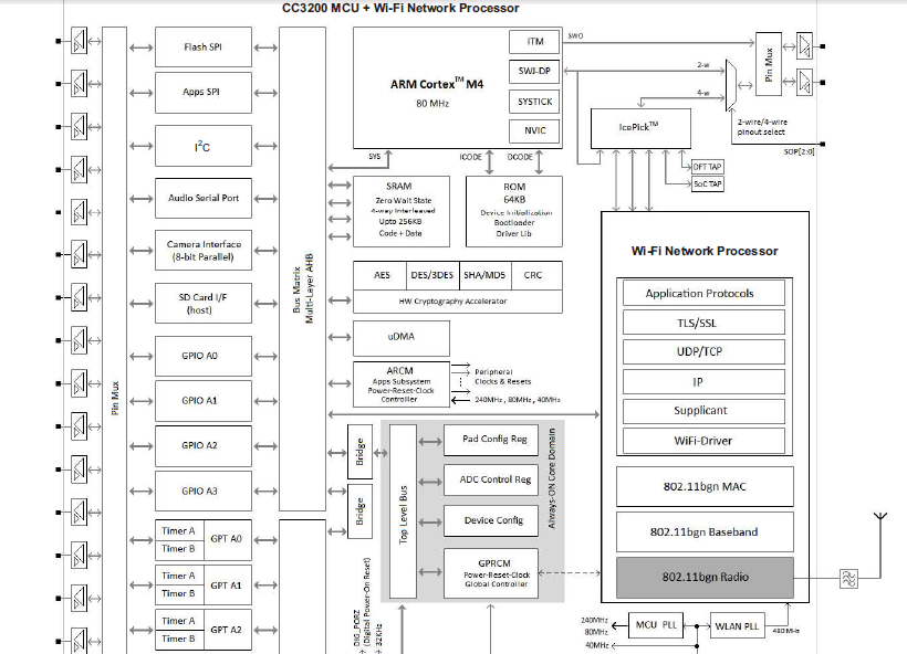

After i used CC3200 launchpad for some months, i find that i can not still understand how APP Processor connected to network processor in CC3200.
I have looked for the information from document but not found. So my question is :
1. There are two SPI interface in APP processor, one is GPSPI for user, the other is for SPI flash. Communicates the APP processor with network processor through spi-flash ?
2. According to the diagram the spi flash saves the application image and data files. But if i dont use SPI-flash(Jumper not moved), then i use IAR to debug an application and it works. There are many evens (wlan events, netapp events) that must be from NWP, how dose APP processor get the events from NWP? Between NWP and APP processor is there a ram or an interface to communicate ? That is the diagram 1 from your document. And from an other document  i saw that the coummunication between them is through AHB......

  • In the code driverlib i have seen that there are 3 spi : SSPI, GSPI and LSPI
    SSPI: SPI flash,   GSPI : User   LSPI : Link, maybe LSPI is for the communication.
    I think maybe LSPI is very important and user should not use it or ti wants to avoid the usage of user, so we can not get any information about it.
  • Hi Zhang,
    The communication is indeed through an SPI interface that is not exposed to the user.
    -Aaron
