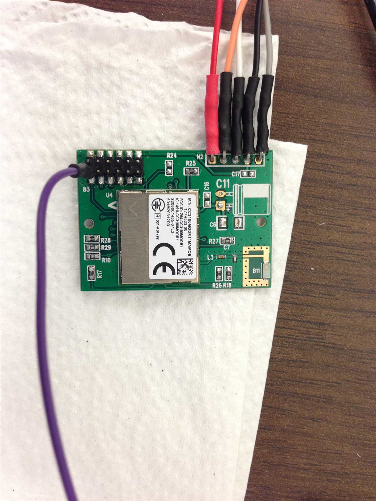

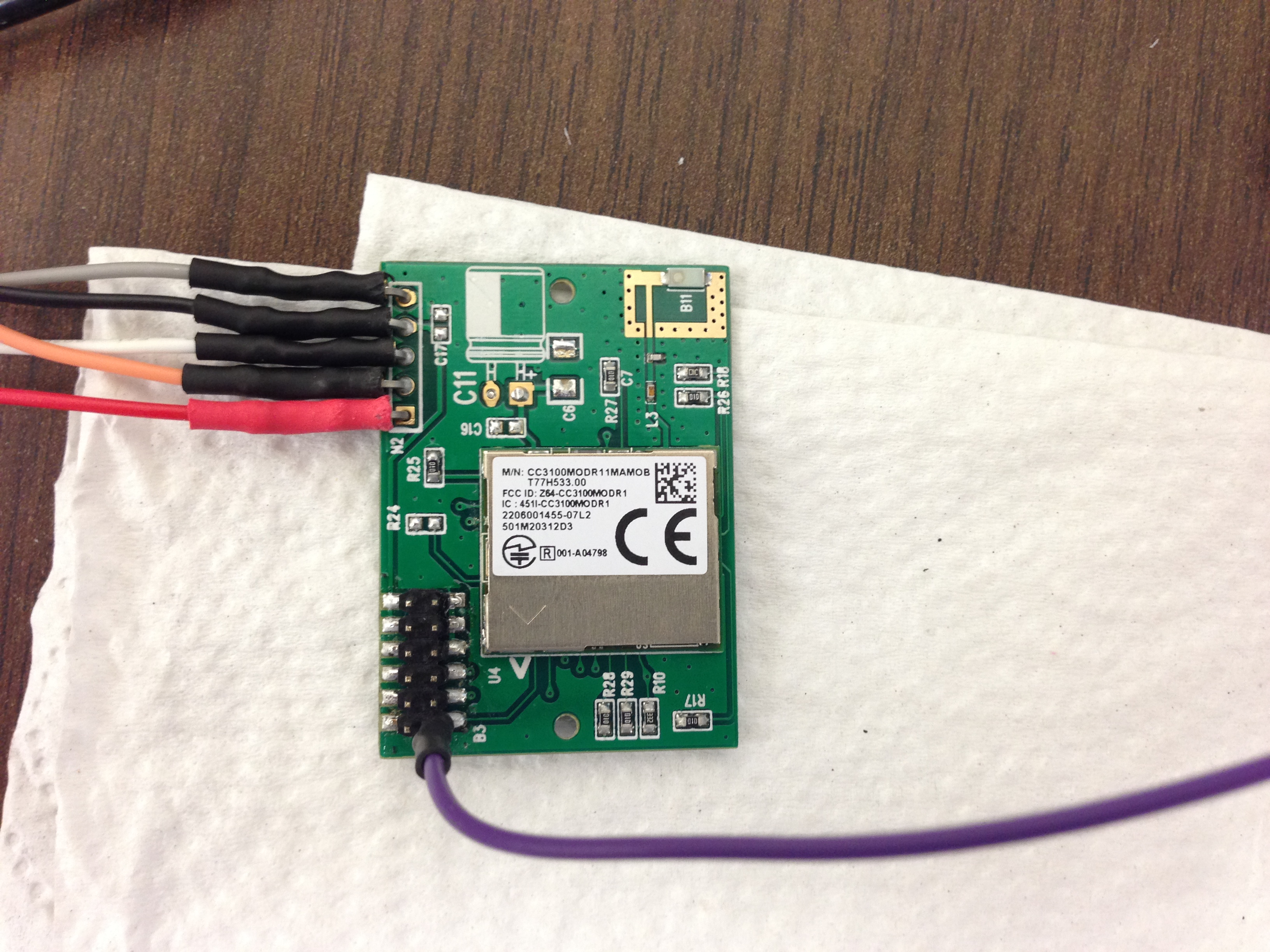

I am using CC3100XXEMUBOOST to format SFlash on CC3100MOD.
Setup:
CC31XXEMUBOOST Rev 3.0
Uniflash Ver: 3.2.1.00000
CC3100MODR11MAMOB jon customer board,  refer to reference design.
Connection: P1.3 (UART1_TX)  <-> Pin 46
  P1.4 (UART1_RX) <-> Pin 47
  P1.1 (VCC) <-> VBAT
  P3.2 (GND) <-> GND
  P1.5 (nHIB) <-> Pin 4
  P2.5 (nRESET) <-> Pin35
The format failed. Please refer to the following details.  Also for programming SFlash, aren Reset and nHIB connection required?

The board and components were designed and selected as per reference design.
