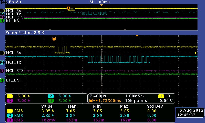

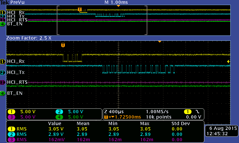

  • Hi Joseph Gigi,
    Thanks for your reply.
    I verify proper power up sequence of the device (as per datasheet).
    so hciattach send 4 byte command to device then device send back to host..below snap i did with scope.
    The attached scope trace channel assignments:
    1. HOST_TX  / HCI_RX
    2. HOST_RX / HCI_TX
    3. HCI_RTS
    4. BT_EN
    When I set BT_EN high, the chip takes 114ms for HCI_RTS to go low.The jorjin datasheet says this should occur in less then 100 ms according to their datasheet.
    But i still got initialisation timed out.
     RAJ M
