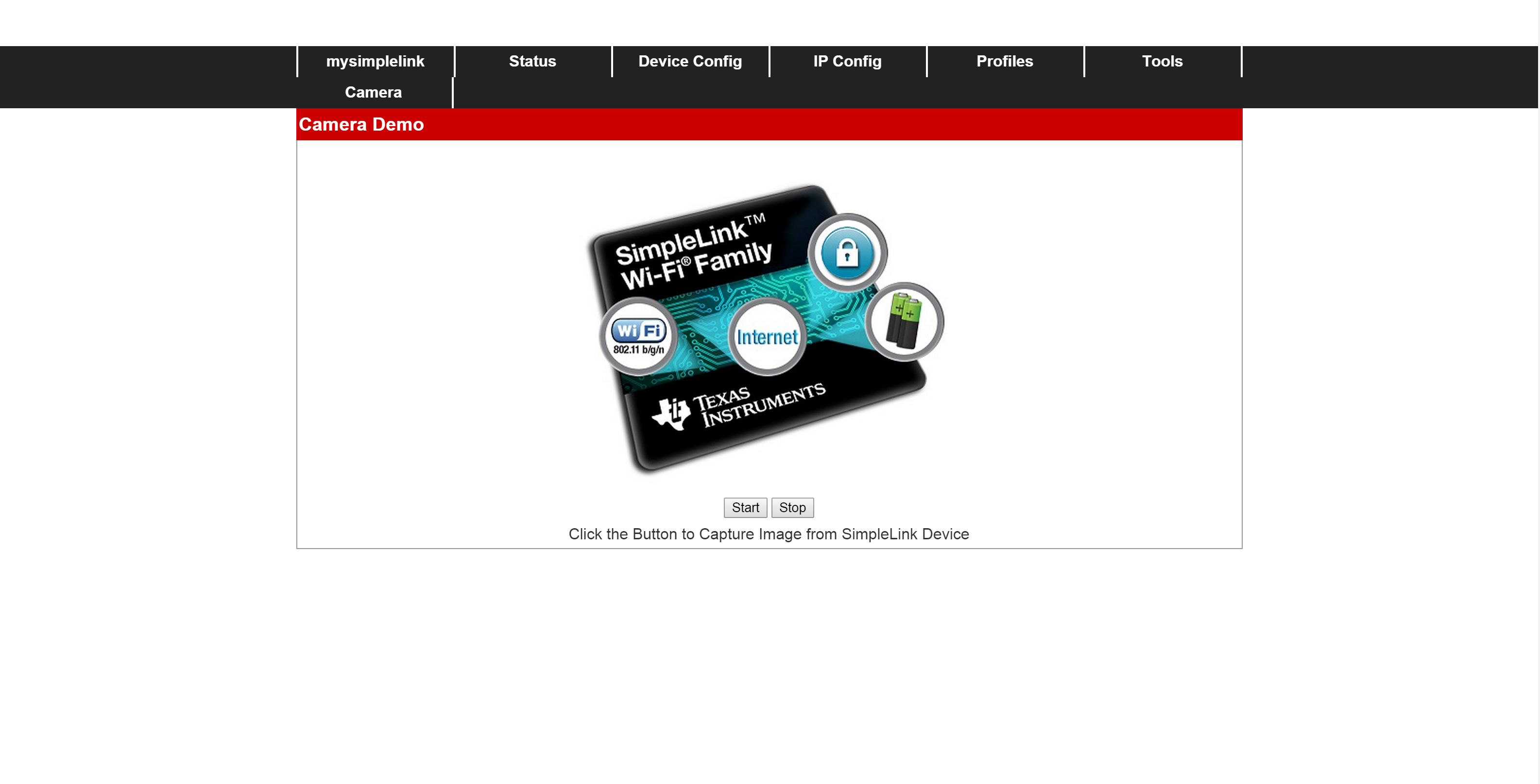

I recently wired the MT9D111 camera to my CC3200MODLAUNCHXL board manually (without the CAMBOOST board-its still coming in the mail) and uploaded both the necessary files via FLASH and BP settings using UniFlash and Code Composer Studio.
When connecting to the CC3200 board as an AP, I am able to load the following page:
When I click on the Start button, I see the Green LED on the board turn on and data transmission is initiated by the camera.
I have probed the VSYNC, HREF, PCLK, PXCLK, DO-D7 lines, and the I2C (SDA and SCL) lines. All of the lines seem to be functioning as they should be, yet I receive nothing when clicking on the Start button.
After clicking on the Start button, I get no video feed on the site.
I have also tried manually going to the following site, but just receive a blank page:
http://mysimplelink.net/images/cc3200_camera_capture.jpg
Do you have any advice on how to move forward?
