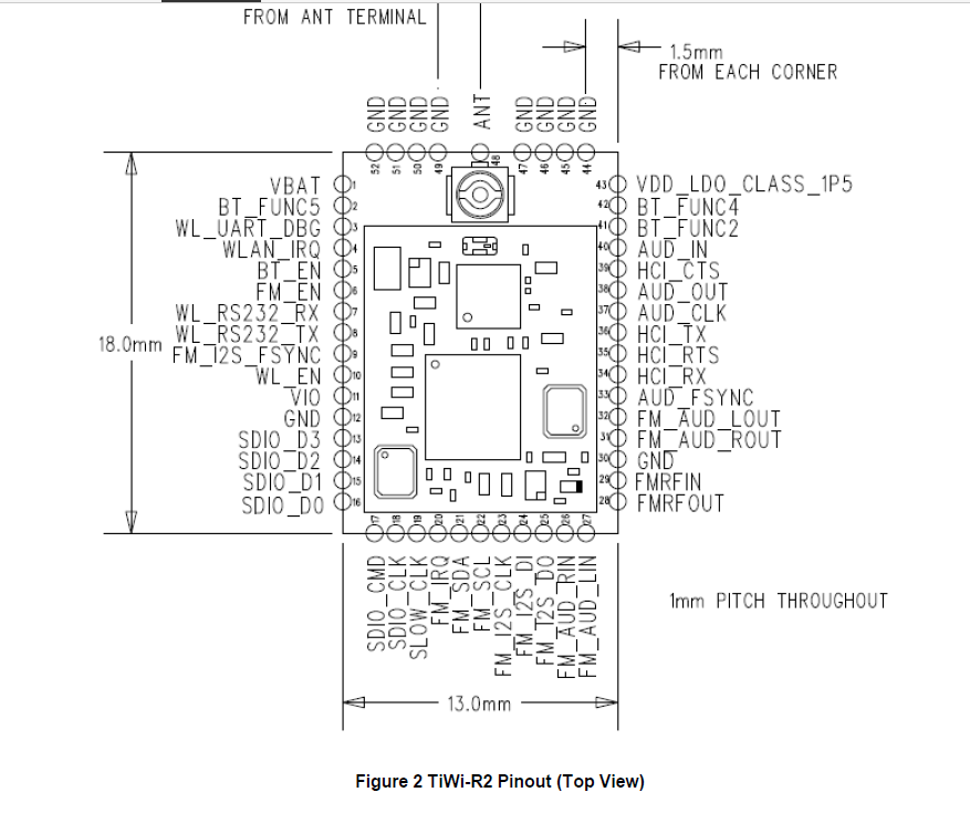

I have a TIWI-R2 module connected by a sdio bus to a Zynq processor on a propretary board.
I'm using the wifi feature only.

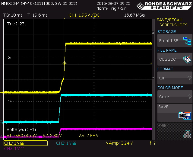

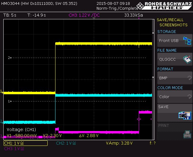

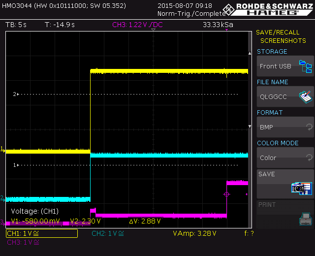

BUT when the system try to wakeup the chip, it does not issue the interrupt.
I have seen that the linux module issue a wakeup command to the chip and wait for the interrupt (wl1271_ps_elp_wakeup function in wlcore/ps.c file)
By using the oscilloscope I'm sure that the chip don't issue the interrupt (performing a 1->0 transition).
The driver fail and the interface become not usable..... After this a lot of other fail from the driver.
