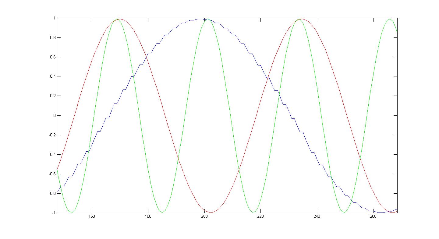

  • Hello Aashish,
    Thank you for your answer.
    None of these configurations worked better than mine.
    So I tried with the original one, witch is R=4,P=1,D=0,J=42,NADC=21,MADC=2 and AOSR=128
    With this configuration, the final gain (including the number of channels in stereo and the number of bit per sample i.e 16) is equal to one.
    For example, at 32k : 32000 x (BitsPerSamples*NbChannels) x (R*J,D/P) x (1/NADC) x (1/MADC) x (1/AOSR) = 1.
    So the frequency of the ADC is equal to the desired sample rate.
    I don't know if I am clear enough.
    So I tried to make a comparaison between configurations at 16k,32k and 64k.
    I included a picture to show you what I got.
    In green :16k
    In red : 32k
    In blue : 64k
    The wave I recorded is at 495Hz, the three waves I recorded don't seem to be at the same frequency because of their sample rates, but they are.
    The wave I get at 48k is similar to the one at 64k.
    It looks like the I2S input buffer of the cc3200 is repeating many samples along the wave.
    Could someone explain me what I misunderstood?
