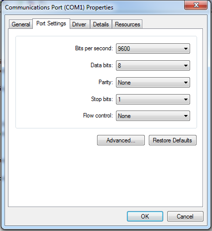

After receiving my CC3200 MCU, I successfully loaded the HTTP Server example and also one or two others. Such process involved successfully flashing to the device through Uniflash and also writing to the board from CCS. I was also using TeraTerm to view the serial messages as well.
After poking around in the device manager properties for the communication port, I changed the bits per second from 9600 to 115200 (because that is what TeraTerm always needed to be switched to when viewing the terminal).
I unfortunately think that this blind tinkering in the settings bricked my device. Ever since the settings change, I can not get Uniflash or CCS to successfully connect to the device.
The com port still identifies it as a FDTI device.
I get the following error in Uniflash when trying to program or format it..
INFO: setting break signal
INFO: --- please restart the device ---
ERROR: ---reading ACK signal failed---
I have verified that the SOP2 jumper is in.
Is there anything else that I can do to get response from the board?

  • Hi Logan,
    If you change the Baud Rate back to 115200, does the error still happen? Are you sure that the COM Port for your CC3200 Launchpad is COM1?
    - kel
  • The attached picture was just a screen shot without the device plugged in. I verified that I was trying to write to the correct port when troubleshooting.
    Also, I tried it back on 115200, as well as restoring back to default settings on the comm port. Both of which threw the same error.
    EDIT: Some info that i forgot to include.. In the board setup instructions, it states that Red LED D7 should blink slowly 3 times then turn off, the board no longer does that.
    Logan
  • Logan,
    I did the same experiment on my side but could not reproduce. I even chaged to HW flow control instead of none and it works.
    The Uniflash driver ignores the settings and opens the COM port with the required settings so I cannot see how it can happen.
    Are you sure the right COM port is used, SOP2 is connected and no other application (e.g. terminal emulator) grabbes the port?

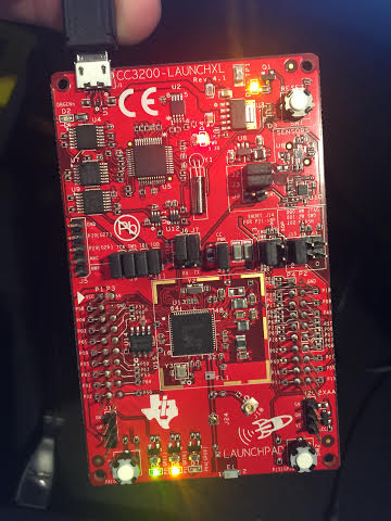

    when i am trying to flash my cc3200 board by using uniflash ,I am getting errors like below. my board version is rev4.1
    [11:50:24] Begin Format operation.
    [11:50:24] INFO: > Executing Operation: Connect
    [11:50:24] DEBUG: Time-out 15
    [11:50:24] ERROR: open: No such file or directory
    [11:50:24] DEBUG: --- Connection failed trying to reconnect... (1 attempt)
    [11:50:24] DEBUG: --- Connection failed trying to reconnect... (2 attempt)
    [11:50:24] DEBUG: --- Connection failed trying to reconnect... (3 attempt)
    [11:50:24] DEBUG: --- Connection failed trying to reconnect... (4 attempt)
    [11:50:24] FATAL: --- Can't connect to device !! ---
    [11:50:37] FATAL: Error connecting to the device. Please check your COM port settings. Error code: 1
    [11:50:37] INFO: > Executing Operation: Disconnect
    [11:50:37] DEBUG: disconnecting from device . . .
    [11:50:37] Operation Format returned.
    please help me what is the problem
    I am tried by using ccs debug mode also it is not worked for me.
    Is there any problem in my board?
    Thanks in Advance
    Ashok
