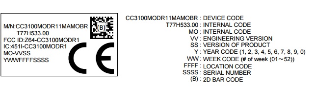

Hello
I want to know.
The data that can be read from the Shield QR code of C3100MOD.
Kozo
according to an answer I got from TI Quality team:
The data matrix in the top left corner of the labels found on CC3100MODR11MAMOBx devices contains the same information found in the date / trace code found on the lower left corner (formatted as YWWFFFFSSSS). As such the code will change with every lot of material produced.
Hi Kozo,
I don't work for TI, so I can't help further I'm afraid. Since it wasn't a MAC address it wasn't what I wanted and didn't investigate further.
Mike
Hi kazo-san,
The Data Matrix on the top right-hand corner contains the YWWFFFFSSSS information:
Hi Kozo-san,
I'm one of the many applications engineers in TI working on the Simplelink Wi-Fi products. If you have any questions regarding the CC3100/CC3200 devices, please feel free to post them in this forum, and we'll have someone to answer the questions for you.
