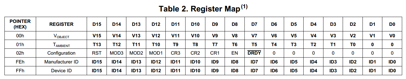

    2.You can see the Register Map in the datasheet of TMP006 and BMA222. For example, the Register Map of TMP006 is as below.
    We can see that the ucRegOffset of Tambient is 0x01h, so we can use the function I2C_IF_WRITE and I2C_IF_READ as following (Just give a example about  collectting data from the temperature sensor (TMP006) ):

    unsigned char ucDevAddr = 0x41;
    unsigned char ucRegOffset = 0x01;
    unsigned char ucLenRD = 2;
    RET_IF_ERR(I2C_IF_Write(ucDevAddr,&ucRegOffset,1,0));
    // Read the specified length of data
    RET_IF_ERR(I2C_IF_Read(ucDevAddr, &aucRdDataBuff[0], ucLenRD));
    UART_PRINT("I2C Read Temperature complete\n\r");
    // Display the buffer over UART on successful readreg
    DisplayBuffer(aucRdDataBuff, ucLenRD);
    return SUCCESS;
