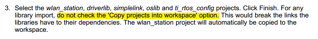

  • Hi Banda,
    Did you import and build the wlan_station, driverlib, simplelink, oslib and ti_rtos_config projects?
    When you launch and start your example projects of CC3200, you should import and build the lib files first.
    You can find the introduce in the CC3200-Quick_Start_Guide.pdf
    CC3200-Getting_Started_Guide.pdf

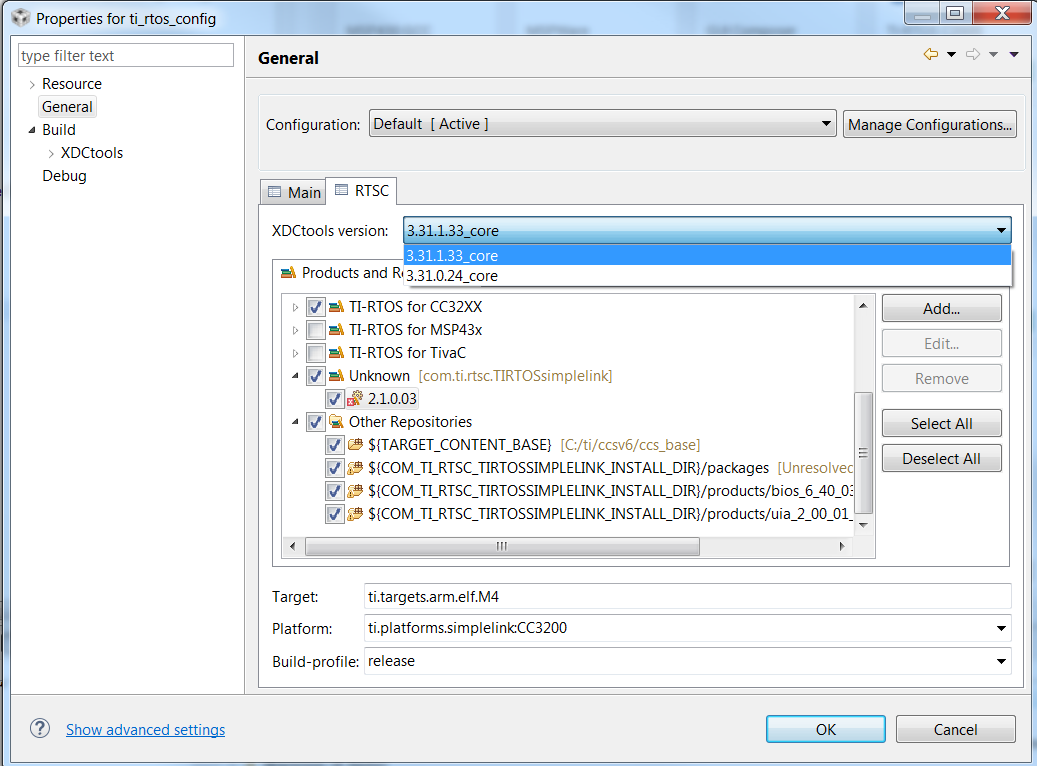

    During Build the lib files,I got errors like this for TI_RTOS_CONFIG,and WLAN_STATION
    FOR TI_RTOS_CONFIG:
    Description:
    Product 'com.ti.rtsc.TIRTOSsimplelink' v2.1.0.03 is not currently installed and no compatible version is available. Please install this product or a compatible version.
    Resource: ti_rtos_config
    Path:
    Location: ti_rtos_config
    Type: Problems
    and for WLAN_STATION
    Description:
    Cannot build project. Referenced project 'ti_rtos_config' contains build-errors.
    Resource:wlan_station
    Path:
    Location:wlan_station
    Type:Problems
    please help me how to solve the problem

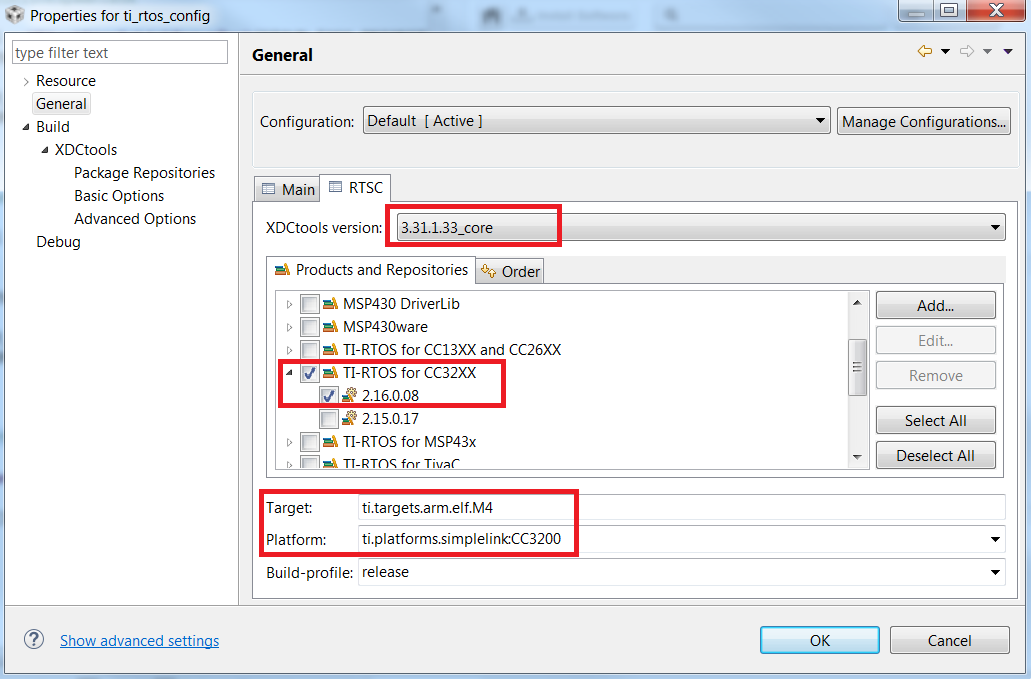

    1. May be you have update the version of TI-RTOS CC32XX or Others in the CCS App Center.
    2. Then you will lose the XDCtools version of  3.30.4.52_core as follows.
    3. You should configure the new XDCtools version as below, and don't check the 'Unknown' option.
    Select the ti_rtos_config project in Project Explorer, and select Project>Properties from the menu. Setup the  ti_rtos_config project configuration as shown below.
    4. Rebuild the TI_RTOS_CONFIG first, and then rebuild WLAN_STATION. Maybe they are OK.
    for point 3 as discussed in the above.......
    By Select the ti_rtos_config project in Project Explorer, and select Project>Properties from the menu. Setup the ti_rtos_config project configuration .......I got
    XDC Tools Versions:
    3.30.4.52_Core[3.31.0.24_core] and
    3.31.0.24_core
    like this....
    How to solve this issue........
    Do you update the version of TI-RTOS CC32XX or Others in the CCS App Center? If not,  that's normal for that the XDC Tools Versions are not the same with me, you just make sure that the "TI-ROST for CC32XX" is  available. You can select one of the XDC Tools Versions, such as the 3.31.0.24_core,  and check there is no 'Unknown'  error appeared as below.
    So,
    1. Select the XDCtools version as '3.31.0.24_core' (or 3.30.4.52_Core[3.31.0.24_core]  );
    2. Deselect the "Unknown" option,
    3. Select one available version of "TI-RTOS for CC32XX";
    4. Select the Target and Platform as discussed in the above, and click OK.
    You can have a try following the steps. Otherwise,please remove the lib files and  re-import or update your related software in the App Center.
