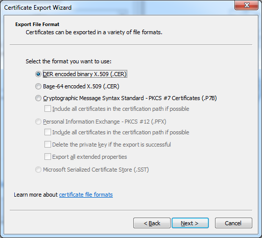

    I want to ask how to get a certificate from a website https
    I want to get the general root CA for connecting to Google through HTTPS which is the GeoTrust Global CA.
    I found this tutorial. Does it's right ?   If it is which format i should choose for CC3200 using.
    Khoa
  • Hi Khoa,
    Yes above steps are right and you need to select der encoded binary format.
    Aashish

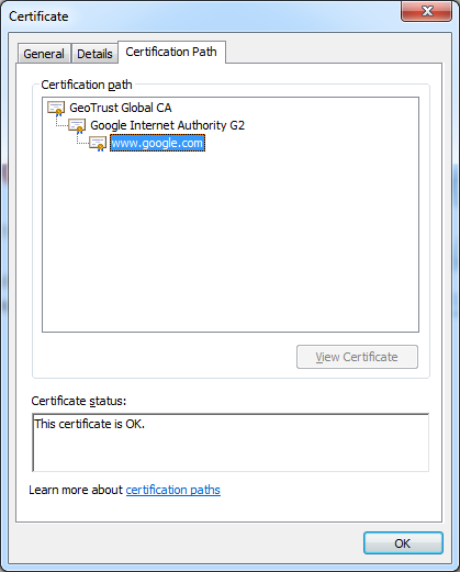

  • Hi Aashish,
    If there are two certificates in the web
    I just run this code below twice right ? run the top level certificate ( GeoTrust Global CA)  first then run the next level certificate  (Google Internet Authority G2) ?
    or just run one certificate ?

  • Hi Khoa,
    Use root CA certificate.
    Aashish
  • Hi Aashish,
    You mean the top level certificate ( GeoTrust Global CA) ?
    regards,
    Khoa
  • Hi Khoa,
    Yes. Top level certificate.
    Aashish
