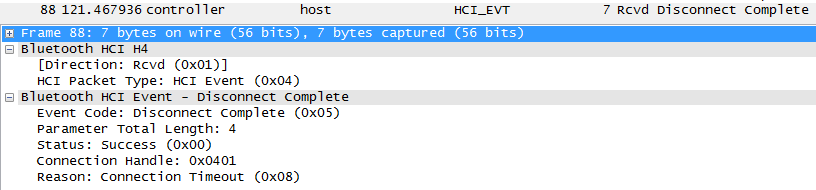

I'm running a GATT server over BLE with bluez 4.101 and have noticed a strange issue. The issue appears whenever I have the server running along with the wireless module and wpa_supplicant active but not connected to a network. When this happens, any connections to the BLE GATT server will be terminated every few seconds. What's odd is that this behavior doesn't occur when the module is active and connected to a wireless network, in which case it seems to function normally. The GATT connection is also steady whenever wpa_supplicant isn't running. GATT over legacy bluetooth doesn't seem to be affected. I've been testing with an ipad and will report back when I am able to test against an android phone over BLE. I'm currently running on a DM368 processor with a 2.6.32 linux kernel, and have backported the bluetooth modules from backports 3.12.2. The wireless module we're using is the LSR TiWi WL1271.

> HCI Event: Disconn Complete (0x05) plen 4
    status 0x00 handle 1025 reason 0x08
    Reason: Connection Timeout

  • Hey Gigi,
    Event 88 in the wpa_sup snoop file does indicate a disconnect, right?
    I'm using the latest BT firmware from LSR (480-0025-R3.0), I'll have to verify the versioning on my WLAN end.
    David
