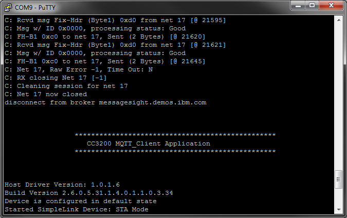

I am having a similar problem. This happen both on SDK 1.1.0 and 1.2.0. My code is suppose to reconnect when MQTT broker connection is lost. I simulated connection lost by removing network cable of the WiFi router. It behaves as expected for about 4 times. But then it consistently fail to reconnect to MQTT broker at the fifth reconnection. After that it cannot reconnect again. The MQTT_client example in the SDKs were not designed to reconnect upon disconnection. For successful broker connection there seems to be a small delay for the sl_ExtLib_MqttClientConnect function call to return. For the fifth and subsequent reconnection, the sl_ExtLib_MqttClientConnect function call return immediately. It is as if the MQTT library does not even make an attempt to connect to the broker.
Eruan Abdul Razak said:I am having a similar problem. This happen both on SDK 1.1.0 and 1.2.0. My code is suppose to reconnect when MQTT broker connection is lost. I simulated connection lost by removing network cable of the WiFi router. It behaves as expected for about 4 times. But then it consistently fail to reconnect to MQTT broker at the fifth reconnection. After that it cannot reconnect again. The MQTT_client example in the SDKs were not designed to reconnect upon disconnection. For successful broker connection there seems to be a small delay for the sl_ExtLib_MqttClientConnect function call to return. For the fifth and subsequent reconnection, the sl_ExtLib_MqttClientConnect function call return immediately. It is as if the MQTT library does not even make an attempt to connect to the broker.
I also have the similar problem and dispite some other TI forum posts, there exists no final and reliable answer to this fundamental MQTT library problem.
After each reconnection with sl_ExtLib_MqttClientConnect(), the "net number" is incrementing. It seems like if the library ends up at the limit of 4 brokers.
I did not find a way to reset the net number to 17 because the MQTT library programming and implementation style is not very transparent.
In my application, a total reset is not possible because user application must continuously run.
Terminal screenshots:
Version: Client LIB 1.0.4, Common LIB 1.1.1.
C: FH-B1 0x10 to net 17, Sent (43 Bytes) [@ 3]
C: Rcvd msg Fix-Hdr (Byte1) 0x20 from net 17 [@ 3]
C: Cleaning session for net 17
C: Msg w/ ID 0x0000, processing status: Good
After 4 reconnections:
C: FH-B1 0x10 to net 20, Sent (43 Bytes) [@ 527]
C: Rcvd msg Fix-Hdr (Byte1) 0x20 from net 20 [@ 527]
C: Cleaning session for net 20
After next reconnection attempt, the library hangs. No debug message, no disconnection callback.
Dear TI employees, could you please provide a final and reliable solution th this fundamental issue?
(Answers like "You can simply call the sl_ExtLib_MqttClientConnect() API to connect to the broker again" in an earlier post do not help)
Thanks and regards
Klaus

Problem solved. Once you detect broker disconnected call sl_ExtLib_MqttClientCtxDelete function before re-connection. I suspect some memory allocation must be released before new connection memory allocation.
Here is a snippet of a pseudo code
while(1)
if((broker_config.is_connected==false) && wifi_is_connected && IP_ACQUIRED)
sl_ExtLib_MqttClientCtxDelete(broker_config.clt_ctx);
mqttbrokerconnect();
Task_sleep(5000);
