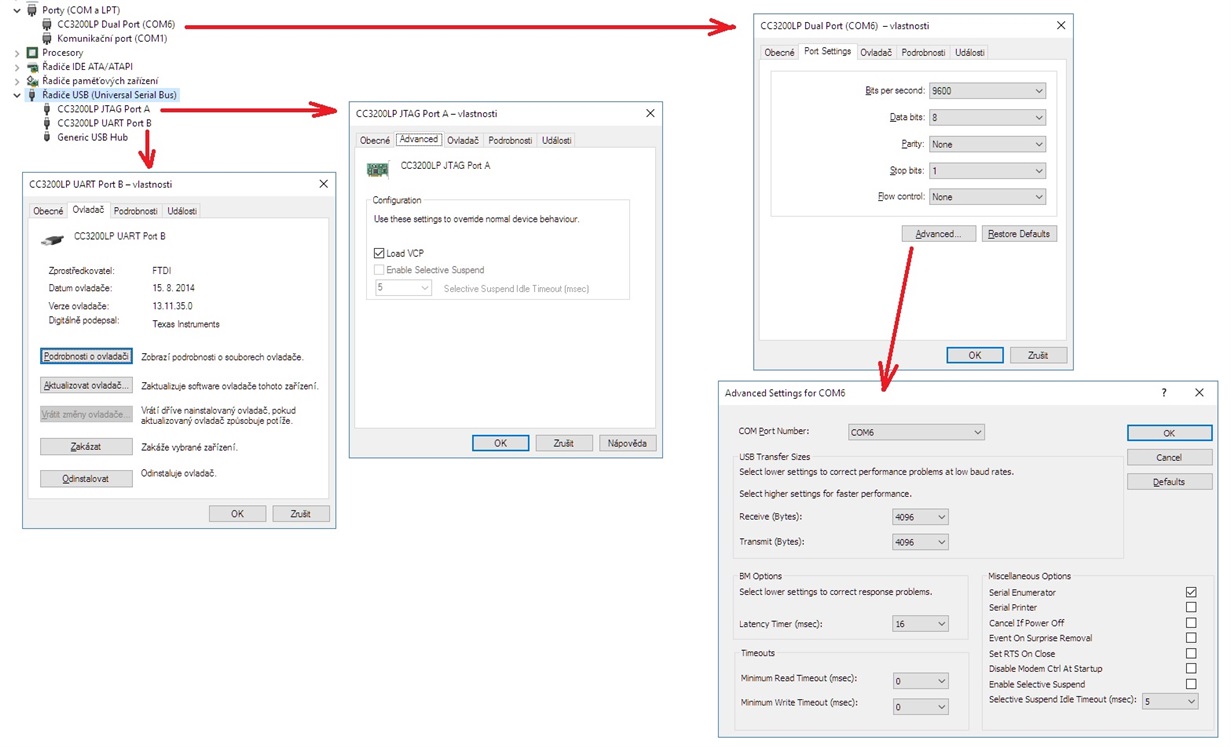

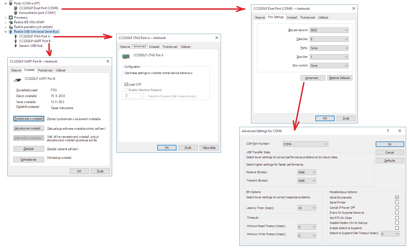

    Can you share screenshot from device manager, my looks this...
    And I use default CC3200.ccxml Target configuration from SDK:
    Jan
  • Hi Jan
    I still need to learn how to do these screen shots... I tried but failed.
    my device-manager settings are exactly same as yours, even the com port number is 6.

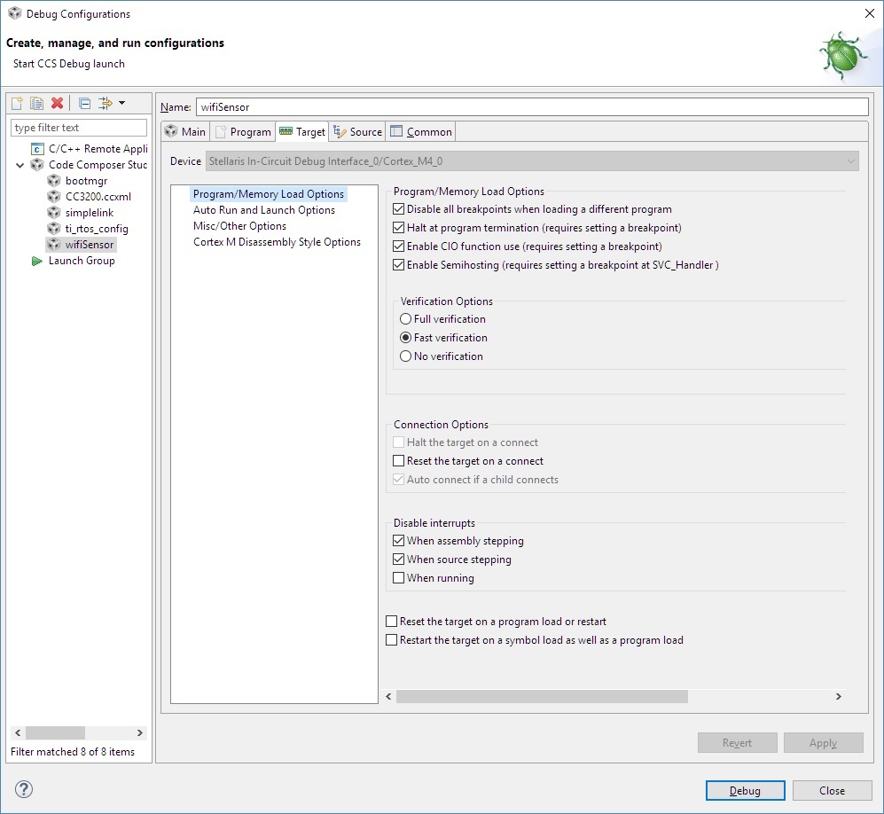

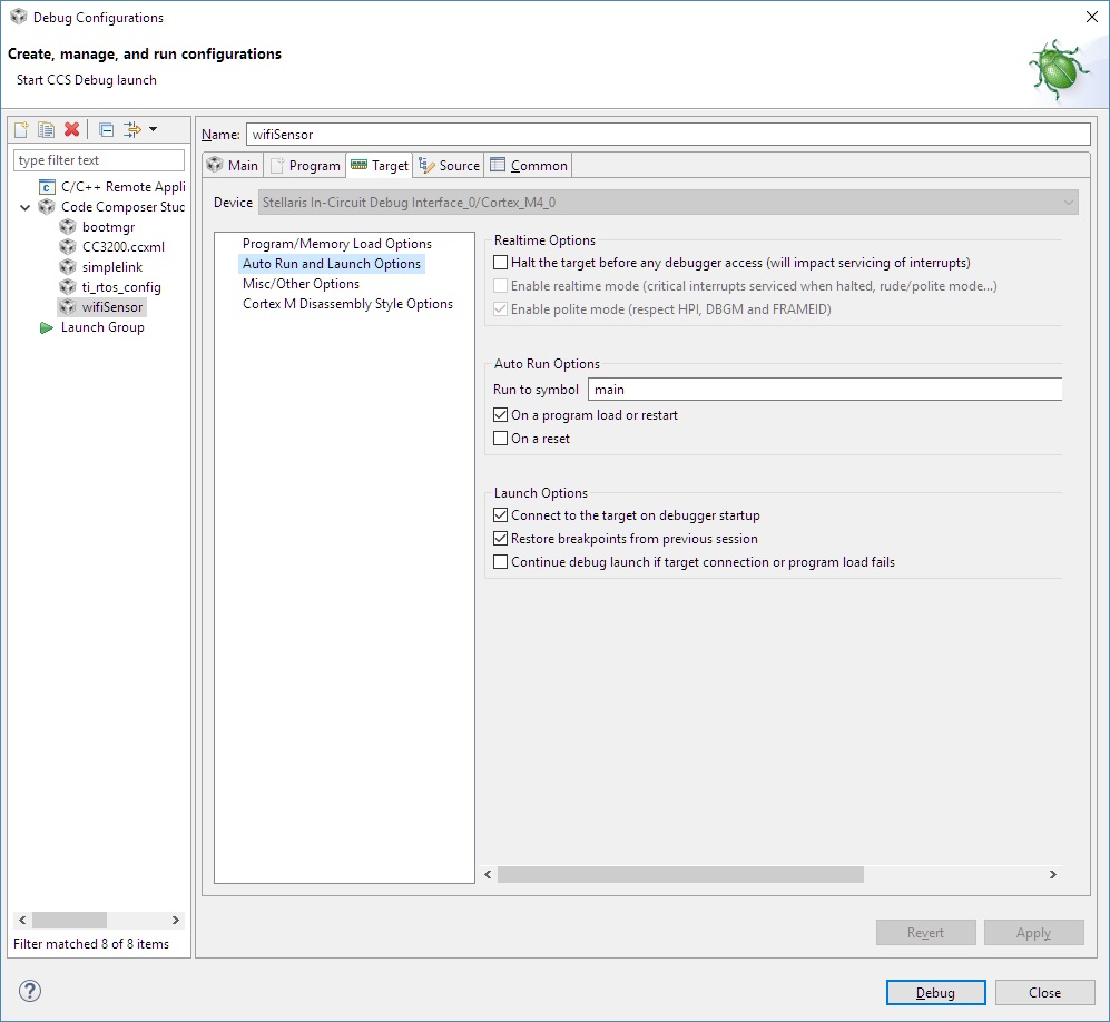

    maybe a too-short timeout somewhere, or s specific settings of the parameters debug->Target-> Auto Run and Launch or in Program/Memory Load
    could you share your settings with me?
    also the example I use include few projects, such as simpleLink, os_lib, ti_rtos_config - maybe one of them has wrong load/start parameter?

  • same as my settings.
