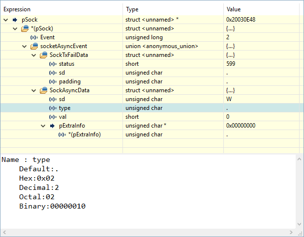

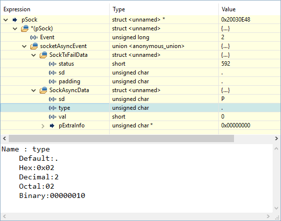

  • Hi Aashish,
    The SimpleLinkSockEventHandler() is regularly called when about 200K of a large file has been downloaded.
    With a 413313 Byte file it occurs at 227322 Bytes.
    With a 323139 Byte file it occurs at 197114 Bytes.
    When downloading a small 1K file the function does not get called.
    After the SimpleLinkSockEventHandler() gets called when downloading the large file it gets called again about 12 seconds later with different data. I'm not sure what is happening there.
    Here is the SLSockeEvent_t data on the first call:
    And on the second delayed call:
