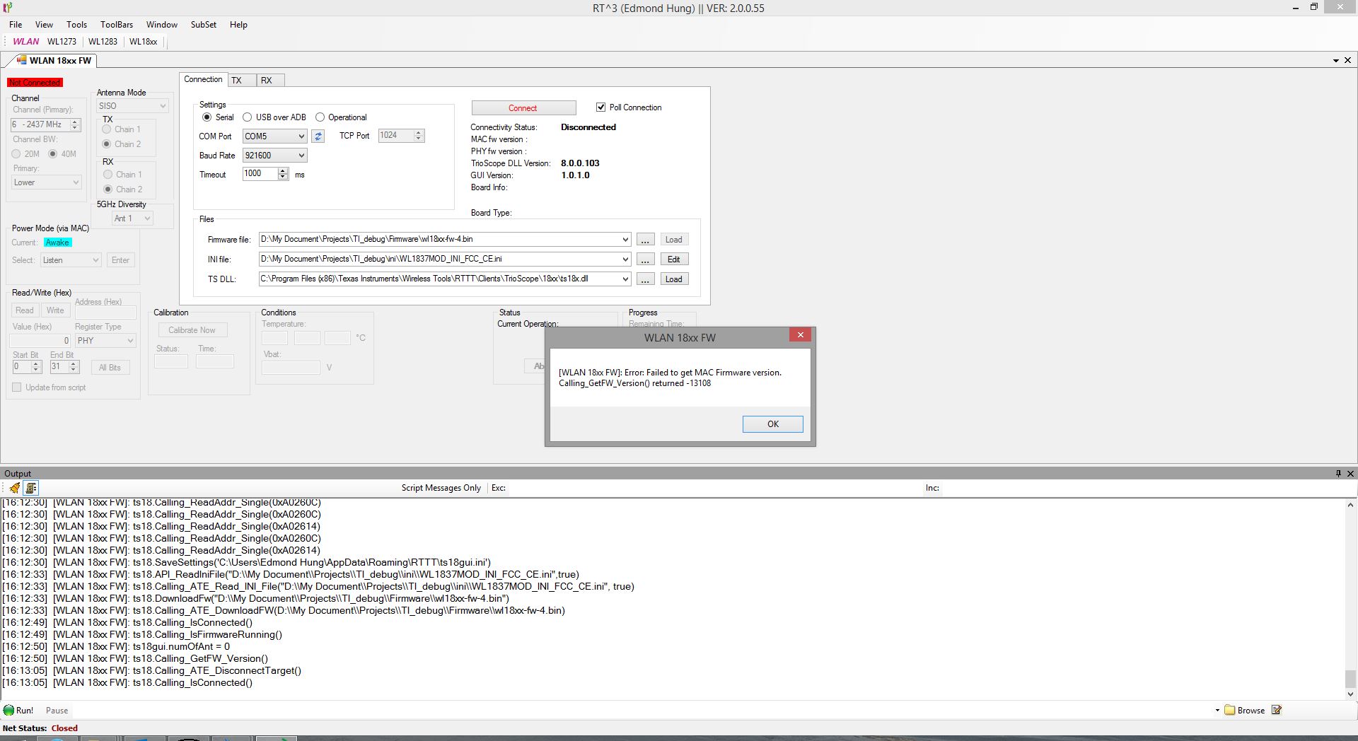

I'm testing the RTTT tool for debugging the module on another board, so I start with a completely function module, the whole board is tested which can connect to an AP and access the internet in the OS.
I start with add a 10k resistor on the IRQ line to enter the debug mode, UART_DBG_BT and AUD_OUT_BT are floating. A USB-TTL(CP2102 chip, also tried FTDI), TXS0108 level shift for the TTL line.
The RTTT can connect without FW. After I load the FW, it gave me:
[16:12:33]  [WLAN 18xx FW]: ts18.Calling_ATE_DownloadFW(D:\\My Document\\Projects\\TI_debug\\Firmware\\wl18xx-fw-4.bin)
[16:12:49]  [WLAN 18xx FW]: ts18.Calling_IsConnected()
[16:12:49]  [WLAN 18xx FW]: ts18.Calling_IsFirmwareRunning()
[16:12:50]  [WLAN 18xx FW]: ts18gui.numOfAnt = 0
[16:12:50]  [WLAN 18xx FW]: ts18.Calling_GetFW_Version()
[16:13:05]  [WLAN 18xx FW]: ts18.Calling_ATE_DisconnectTarget()
[16:13:05]  [WLAN 18xx FW]: ts18.Calling_IsConnected()
[16:13:31]  [WLAN 18xx FW]: Error: Failed to get MAC Firmware version. Calling_GetFW_Version() returned -13108
What is this error for and how can I solve it?

    Update: After I remove the level shifter between CPU GPIO and WLAN_IRQ, I can successfully load the firmware once. But it will disconnect after around one minute. No matter I edit the setting or not. When I click connect again, and load the FW once more, it show the same error again.

  • Hello Edmond,
    From what you are describing it seems you are trying to download the driver over and over again.
    It can only be downloaded once. please make sure the host doesn't download it before connecting with RTTT.
    When measuring things with RTTT the device should be in standalone mode. make sure the boot doesn't run and download the driver or disconnect physically the SDIO.

    Hi Loewy,
    I don't notice that the module still accept the driver from SDIO even in the debug mode.
    Will try to bypass the driver download from host.
    Update: Problem solved after the host doesn't download the firmware through SDIO.
    Thanks for your help.
