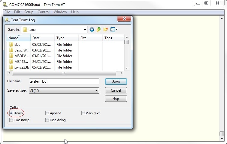

    The procedure is as follows:
    1.     Identify the hardware pin for network logger on CC3200 chipset.
    1.     For CC3200 QFN flavor, it is pin #62 (GPIO07)
    2.     For CC3200 MOD flavor, it is pin #52 (GPIO07)
    2.     Use a level shifter and connect ground and the 1-pin data line
    3.     Add to pinmux.c the following lines:
    1.     MAP_PRCMPeripheralClkEnable(PRCM_UARTA0, PRCM_RUN_MODE_CLK);
    2.     MAP_PinTypeUART(PIN_62, PIN_MODE_1);

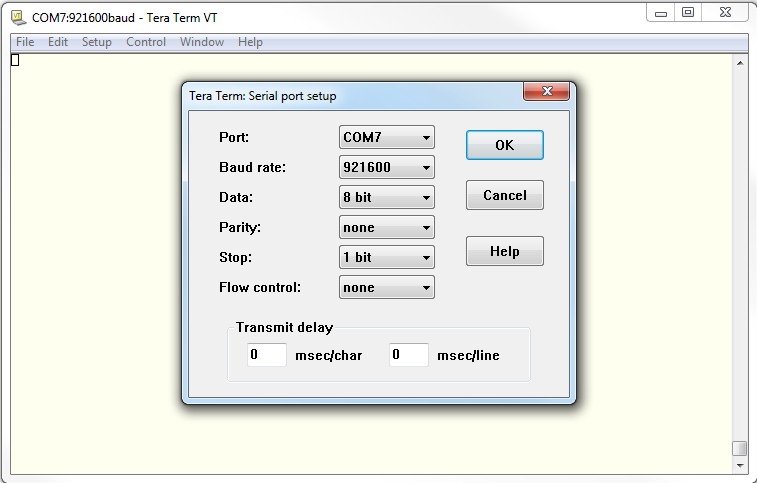

    4.     Open a terminal emulation and configure the followings:
    1.     baud rate: 921,600 bps
    2.     8 bits
    3.     no parity
    4.     1 stop bit
    5.     no flow control

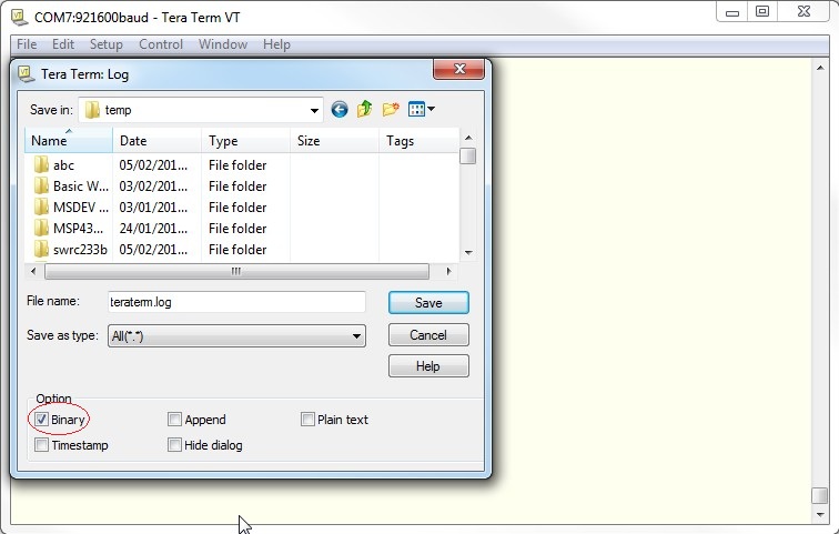

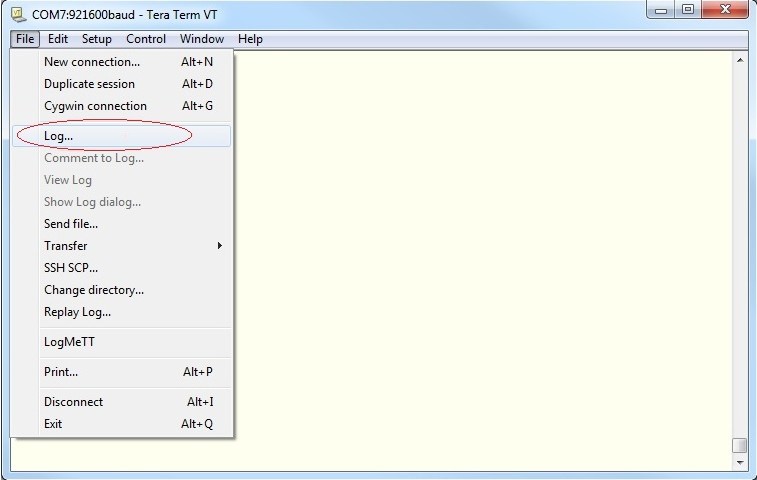

    5.     Configure the terminal emulation to work in Binary mode (and not textual/ASCII mode)
    6.     Configure the terminal emulation to work in "Log" mode so any character that is received from CC3200 chipset device is written to the local Log file. In this phase, binary characters should appear on the terminal window.
    7.     Close the log file when done and send it to TI for post capture analysis.
    For reference, TeraTerm terminal emulation is shown for example:
    1. Open a terminal emulation and configure the followings:
      2. 8 bits
      3. no parity
      4. 1 stop bitflow control
      5. no flow control
    2. Configure the terminal emulation to work in Binary mode
    3. Configure the terminal emulation to work in "Log" mode
    Shlomi
    2.     8 bits
    3.     no parity
    4.     1 stop bit
    5.     no flow control
