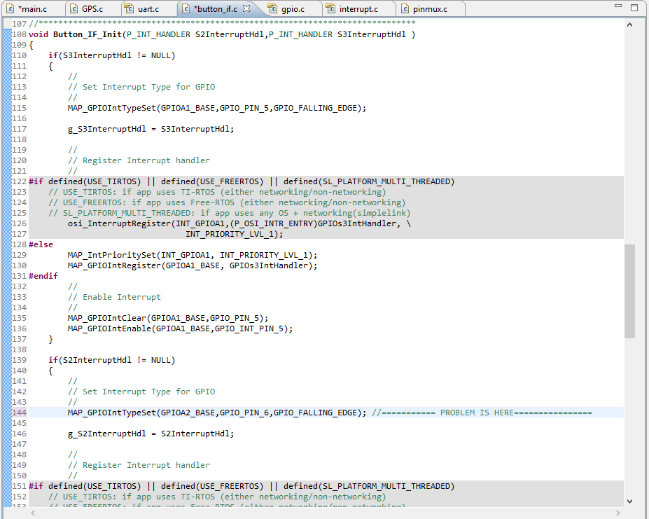

In the test program, I want to use a push button (SW2 on launchpadXL) that makes a call to Button_if.c, the file where it crashes (the program goes nowhere).
More precisely, the call that causes error is :
And then, in Button_if.c :

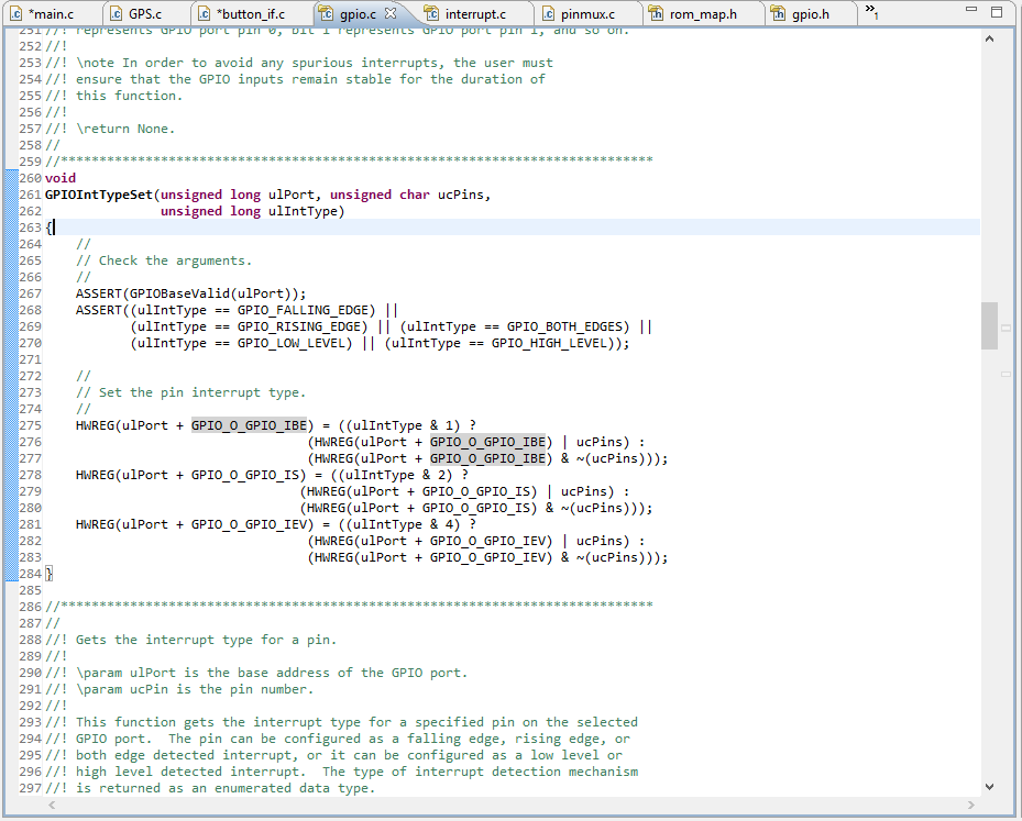

Finally, in MAP_GPIOIntTypeSet(...) :
After the first line in that lat function (press on F6), the code get nowhere, I have no controle on the debug operation and program crashes.

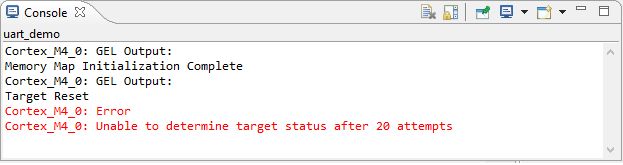

If I press the push button the following error is shown :
What could be the error ? is  a configuration missing ?
