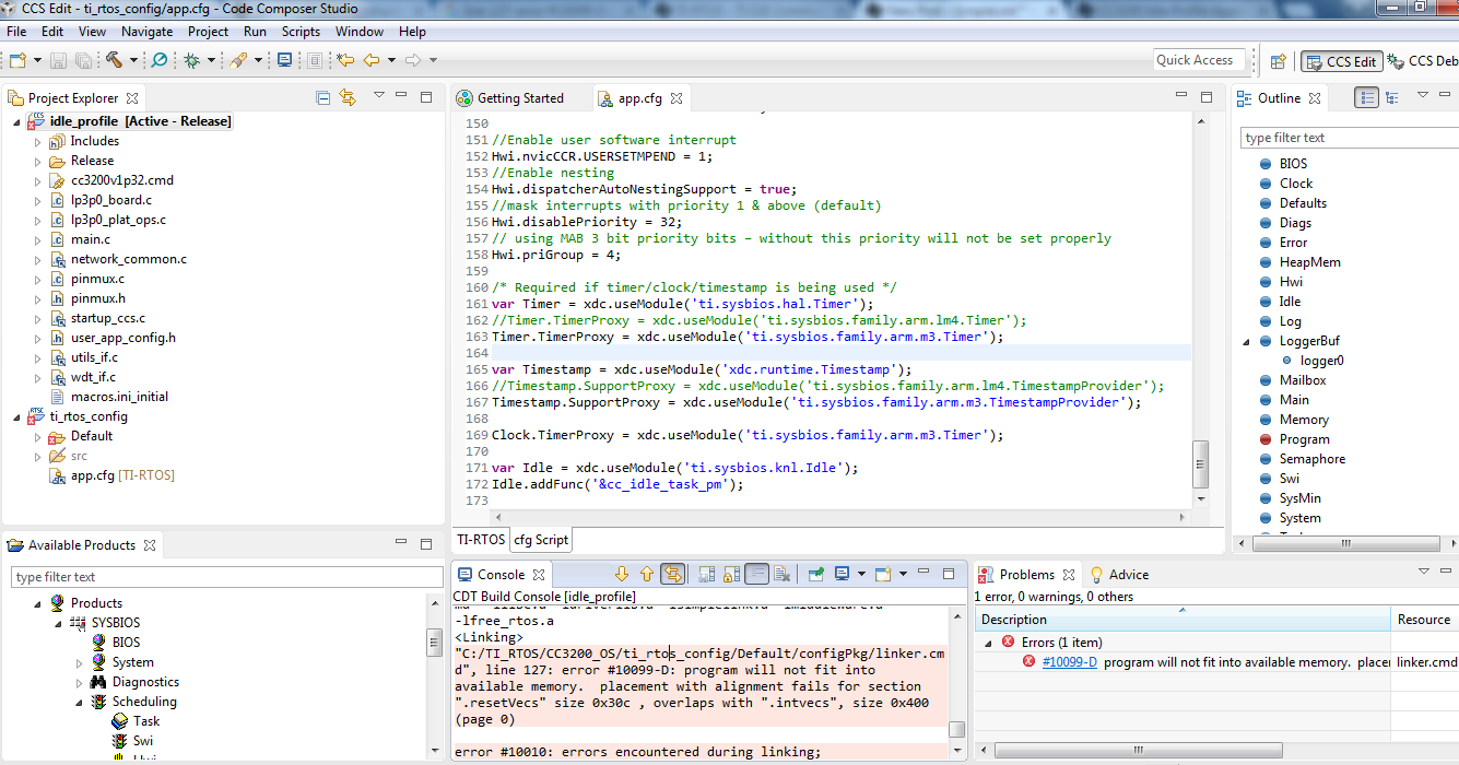

I tried to build CC32xx Idle Profile Application according to wiki page. But I have the following error.
"C:/TI_RTOS/CC3200_OS/ti_rtos_config/Default/configPkg/linker.cmd", line 127: error #10099-D: program will not fit into available memory.  placement with alignment fails for section ".resetVecs" size 0x30c , overlaps with ".intvecs", size 0x400 (page 0)
Please advise me some suggestion how to solve it.
